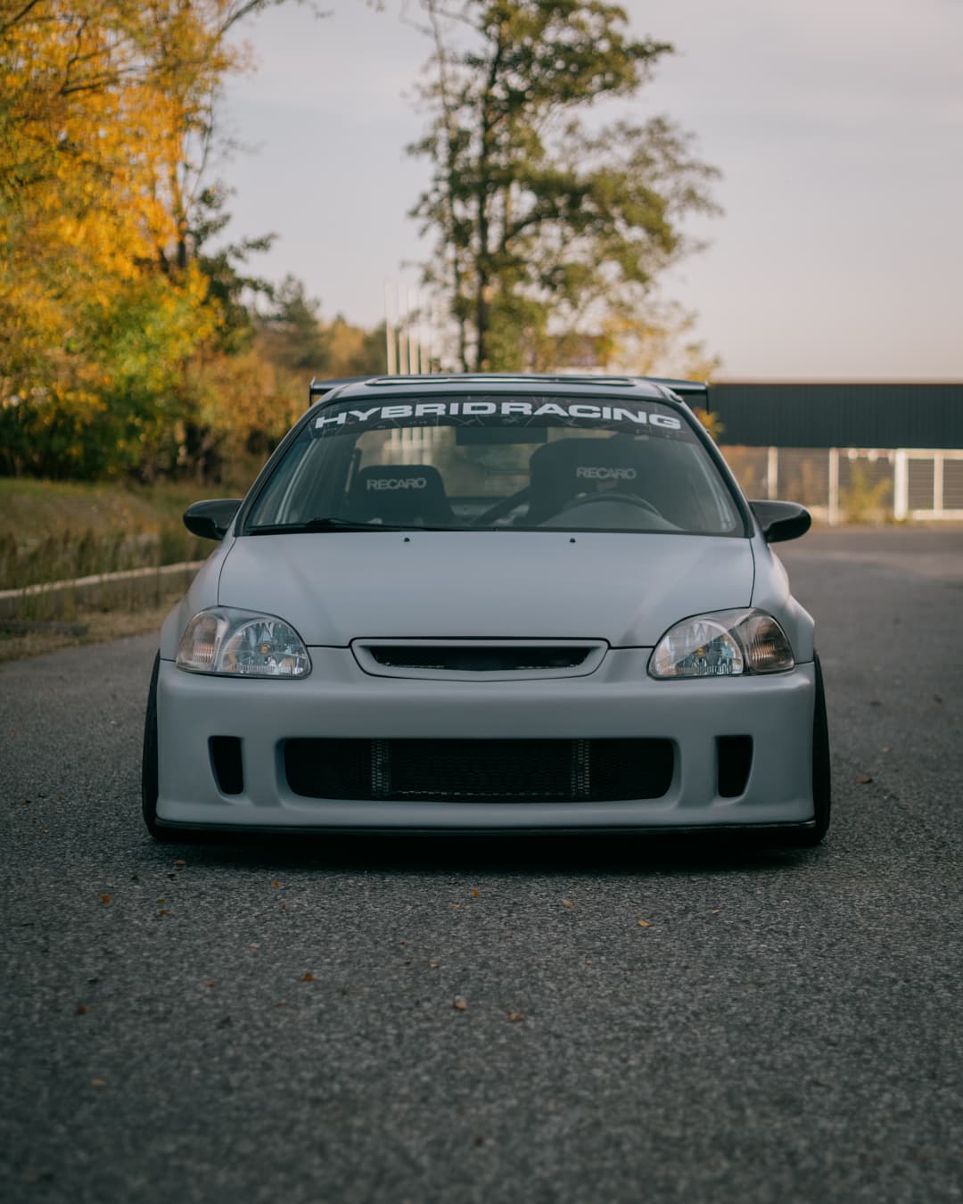

Micha's K20A EK
I loved the build threads back in the days here. Times changed but i still love to read a good old build thread.
This is a little summary of my build i did lately.
I will update with news from now on.
Here some of the “latest” pics:
