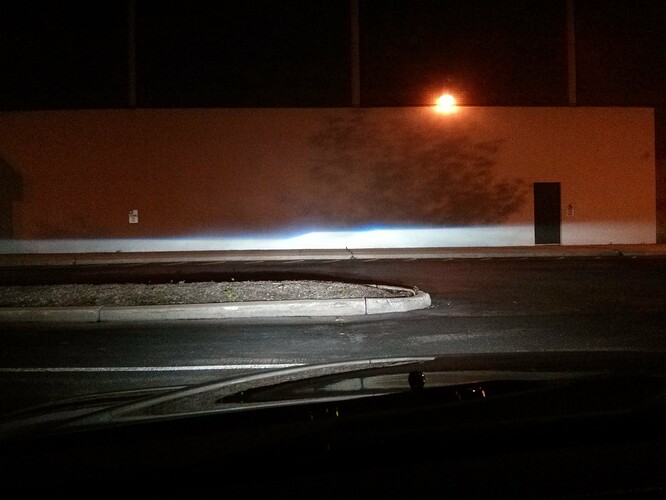

JDM CTR Headlights:
- Lexus RX350 bixenon projectors
- BMW 1 Series projector shrouds
- Osram CBI D2S bulbs
- Denso D2S ballasts
- Morimoto H4 relay harness
