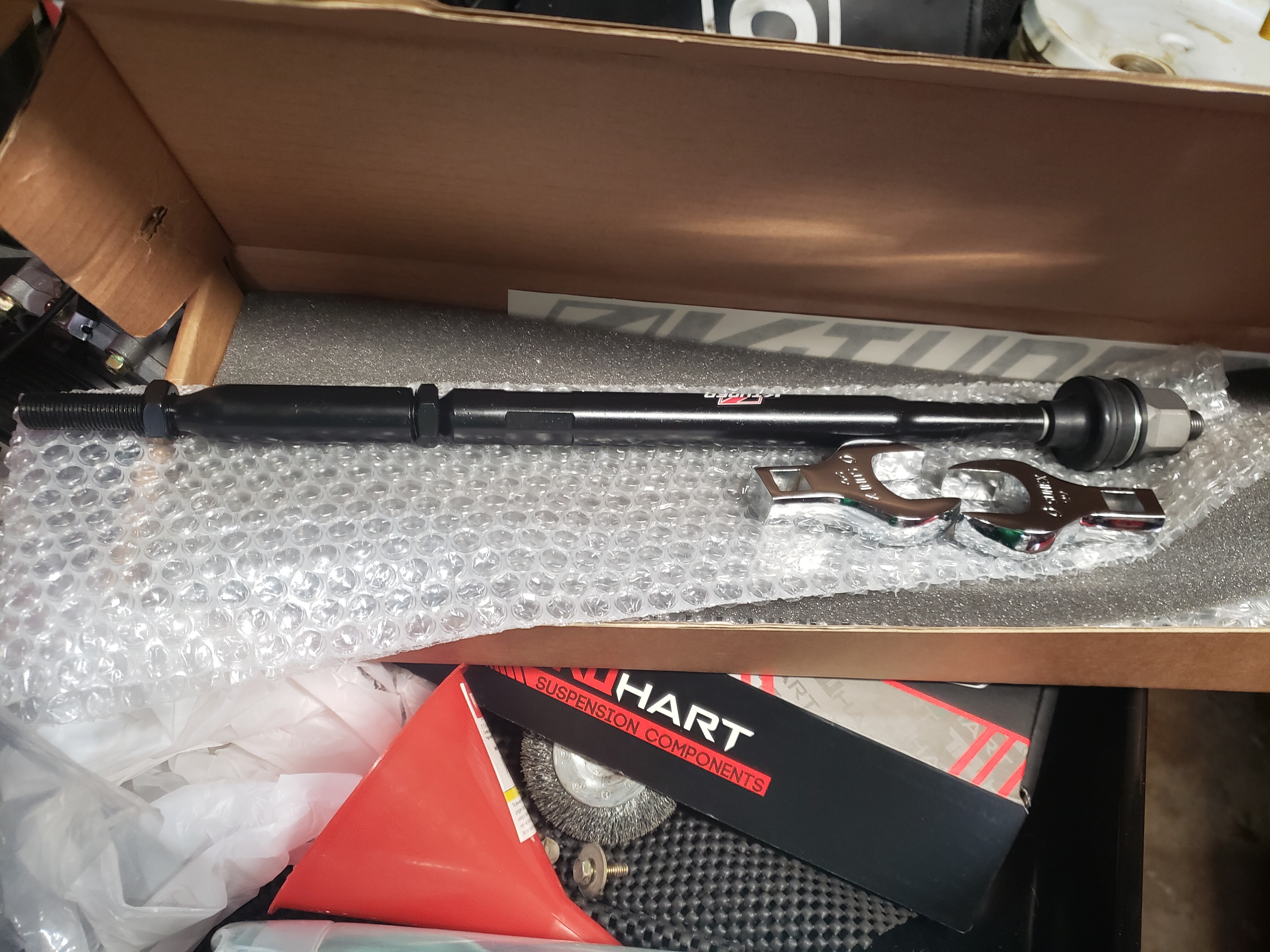

K-tuned inner tie rods and tru-hart rear camber kits

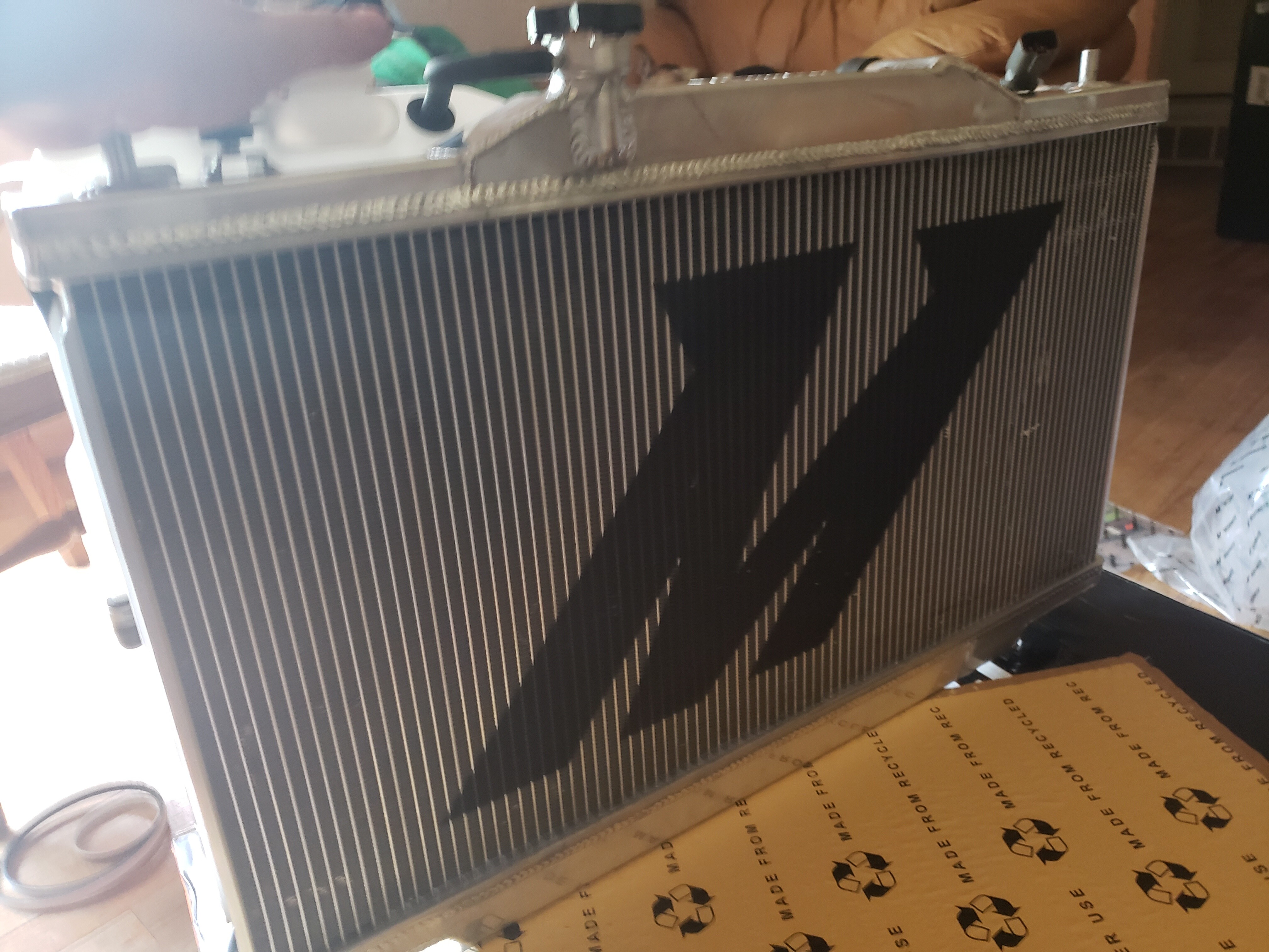

Start of replacing the ac system. Fitted new radiator/fans (one of them oem fans had died at some point) condenser, compressor, drier and a new starter because it was easy to access

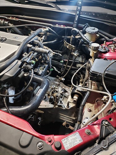

But. On to the meat and potatoes today. Started disassembly for the winter refresh. Doing a bit on transmission work and trying to stop this from leaking oil every where like its been doing.
This is the bolt hole honda recommends for supporting the trans while the engine is out. You have to loosen your heater pipe and the bracket that receives the bolt from intake bracket to a access it. Rather annoying.
