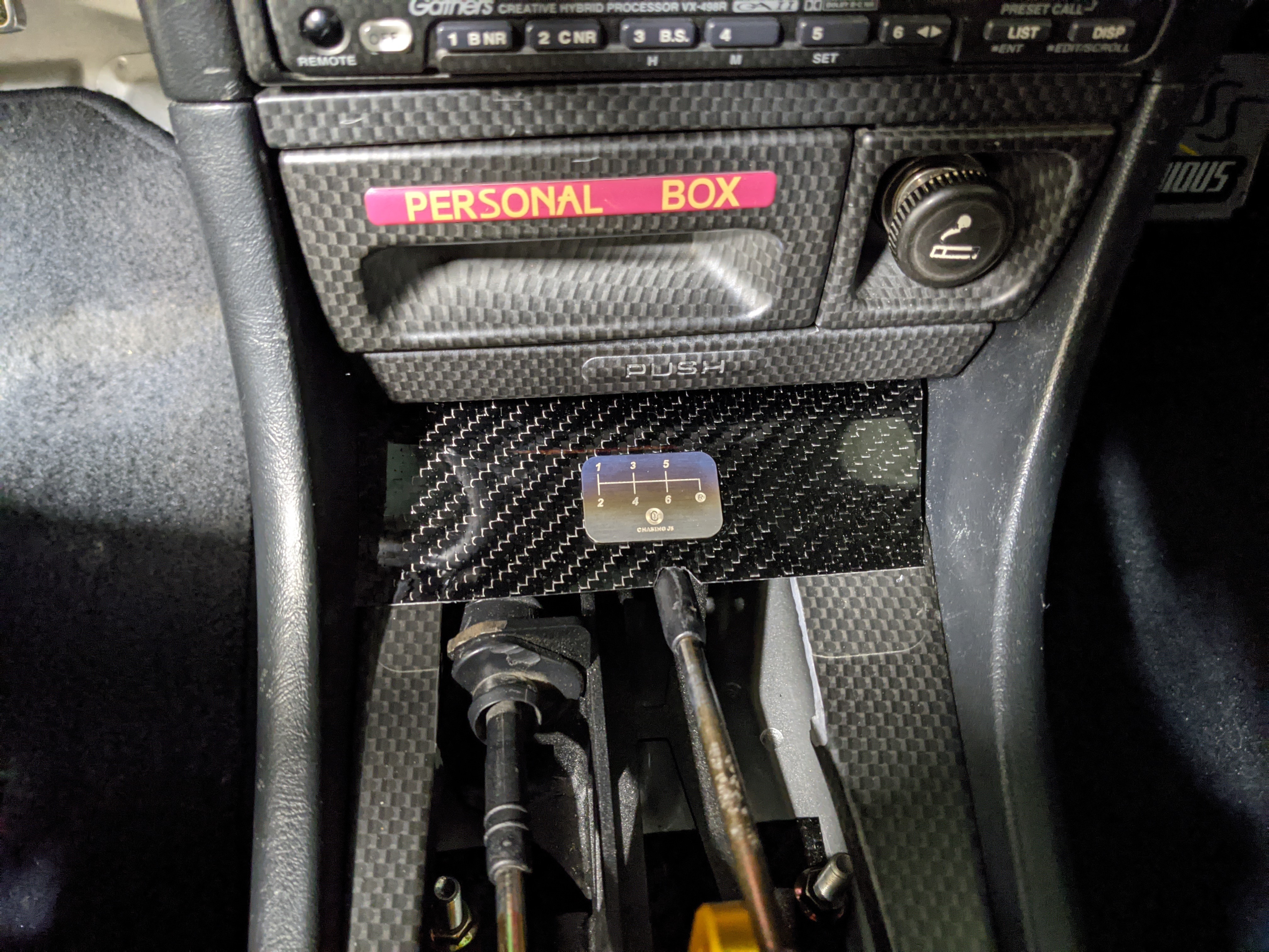

Added a piece of carbon fiber to the empty area of the shifter console that I had cut for the shifter cables to work. Added a chasing J’s 6-speed plaque while I was at it.

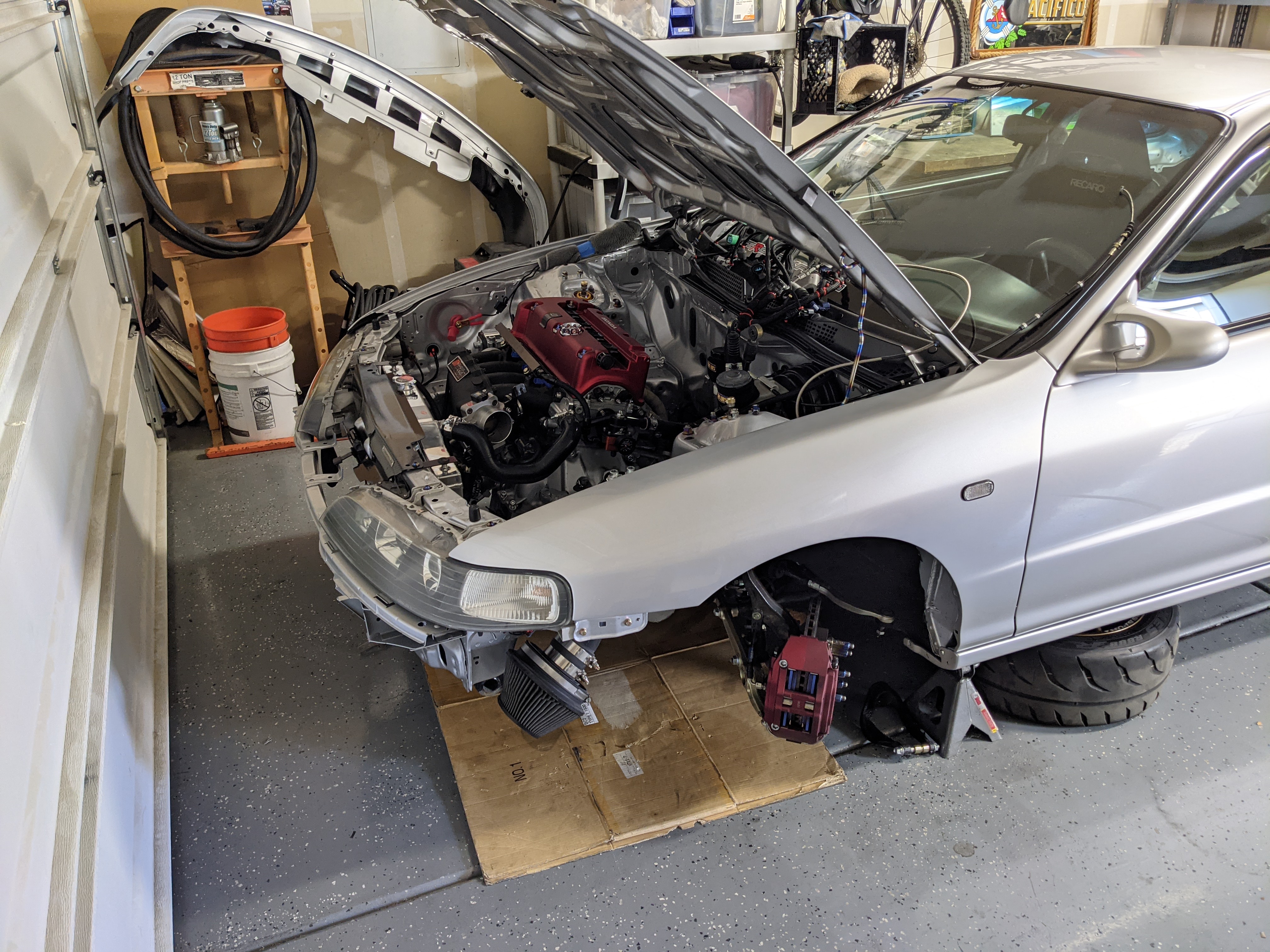

Had a few days off from work so took advantage and pulled the swap out. Hoping to tear the motor apart next week.

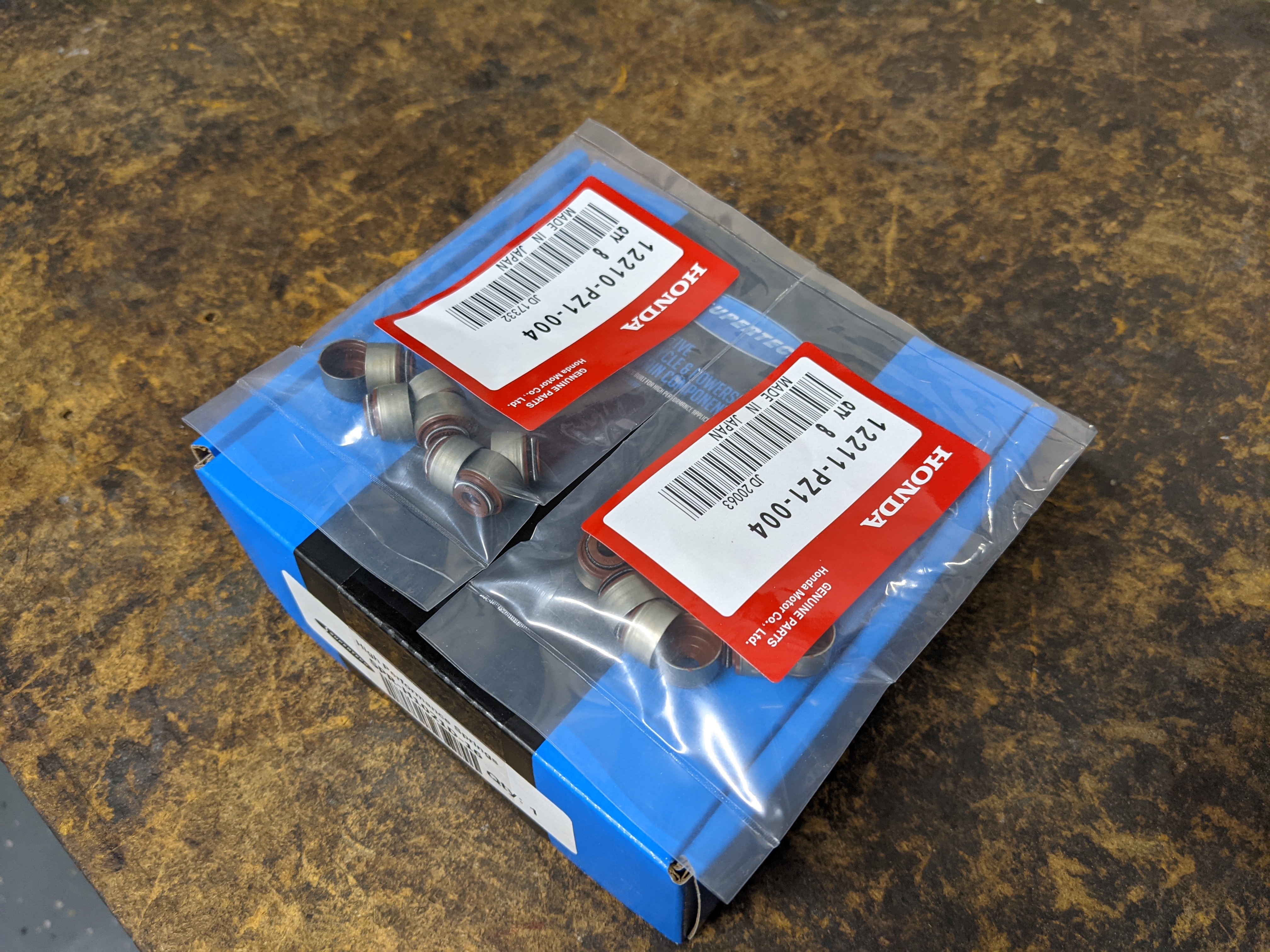

Got a couple of things in for the motor build. Supertech valve springs and OEM valve seals

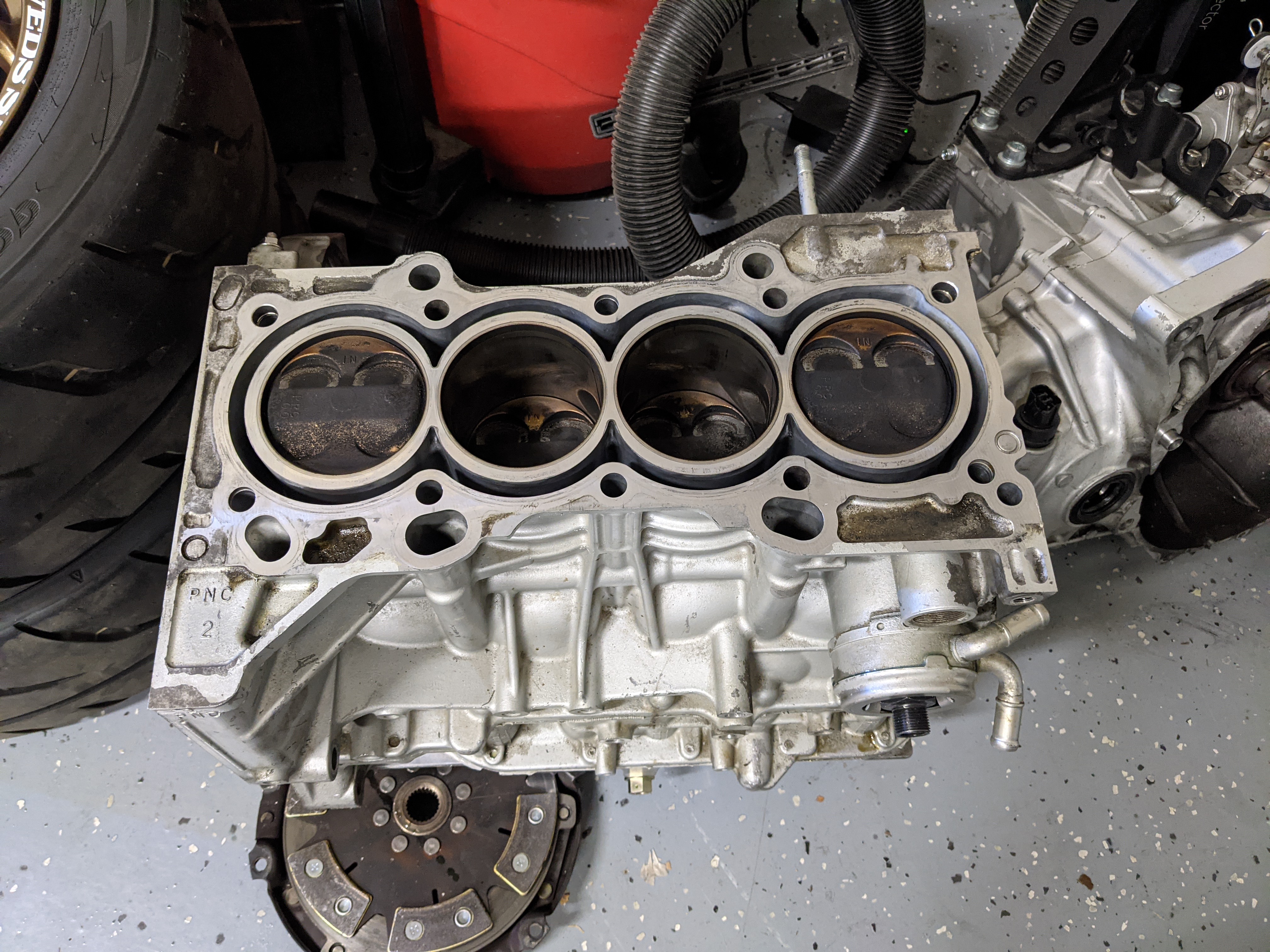

Got some work done on the old motor.
Stripped the long block of most components to prepare for head removal

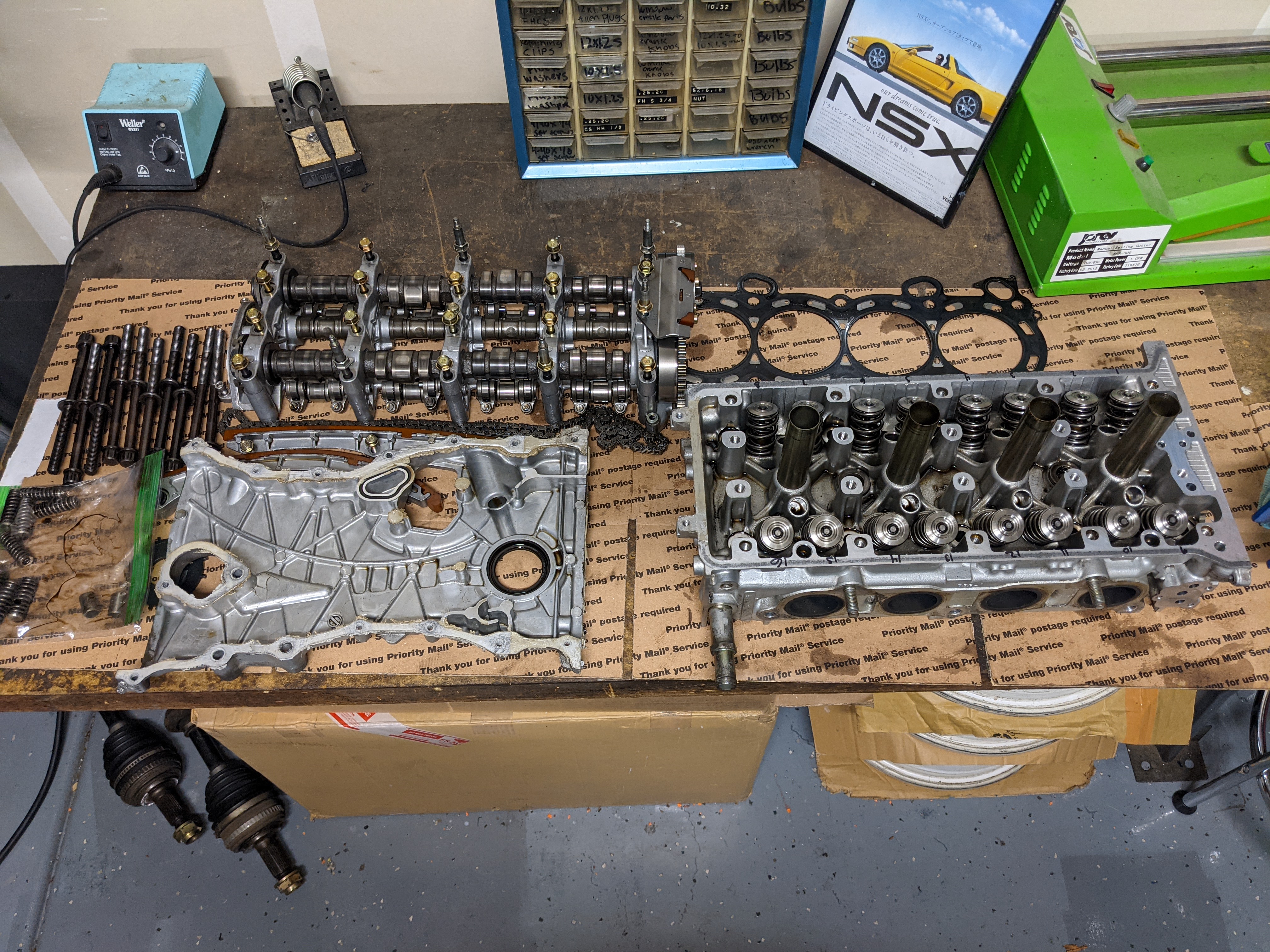

Head is off and looks to be in good shape!

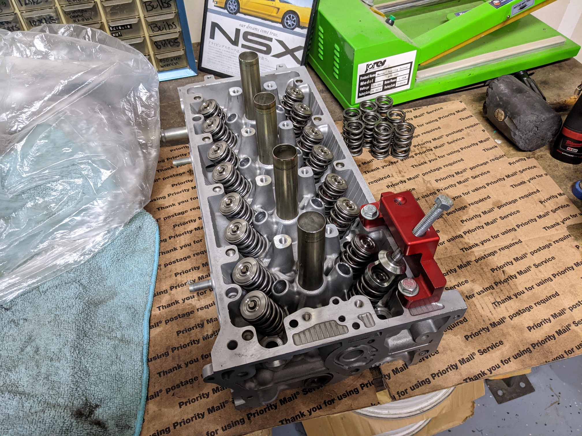

Got the head back from the machine shop. It was supposed to be just a resurface but after they did a vacuum test they saw leaks coming from the exhaust valve guides and a small amount from the valve seats.
Went ahead and changed out the exhaust guides as well as got a 3 angle Valve job.
Swapped over the new supertech dual valve springs and the head is now ready!

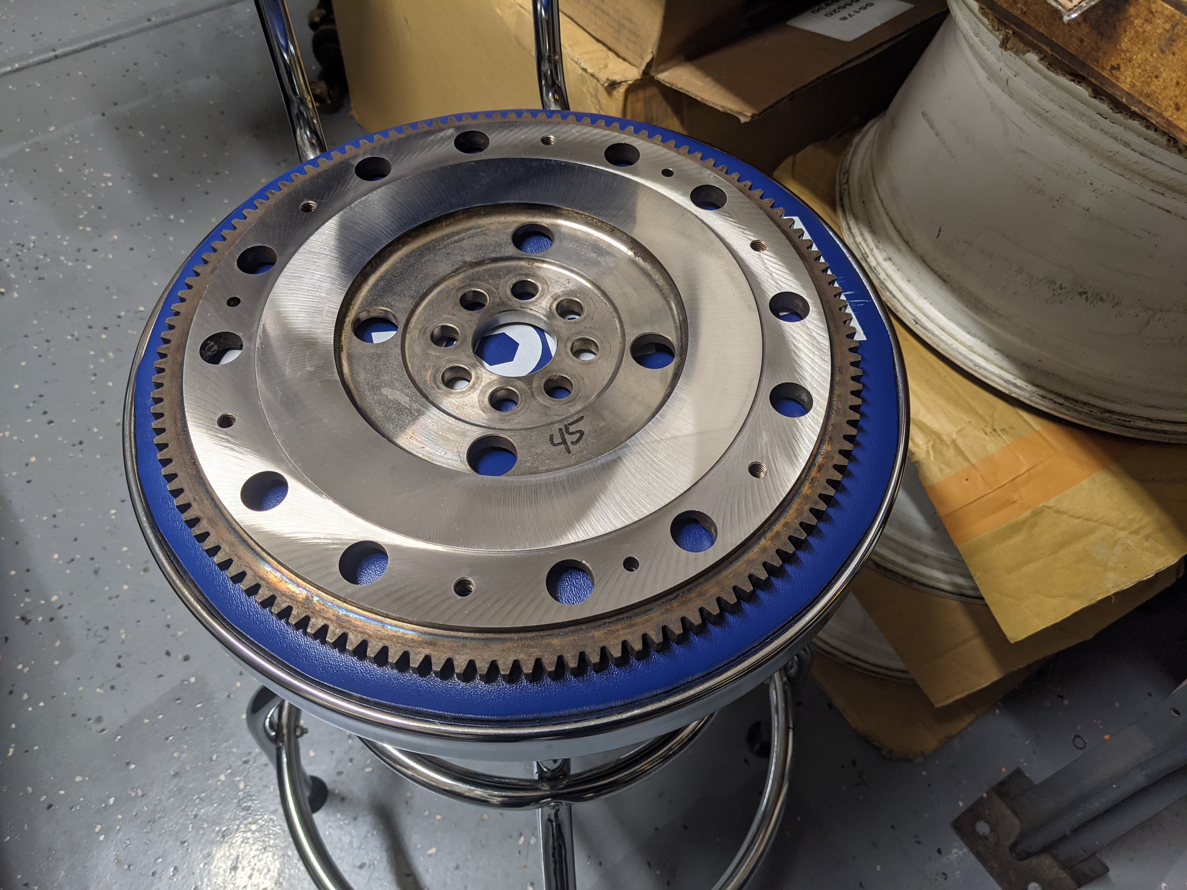

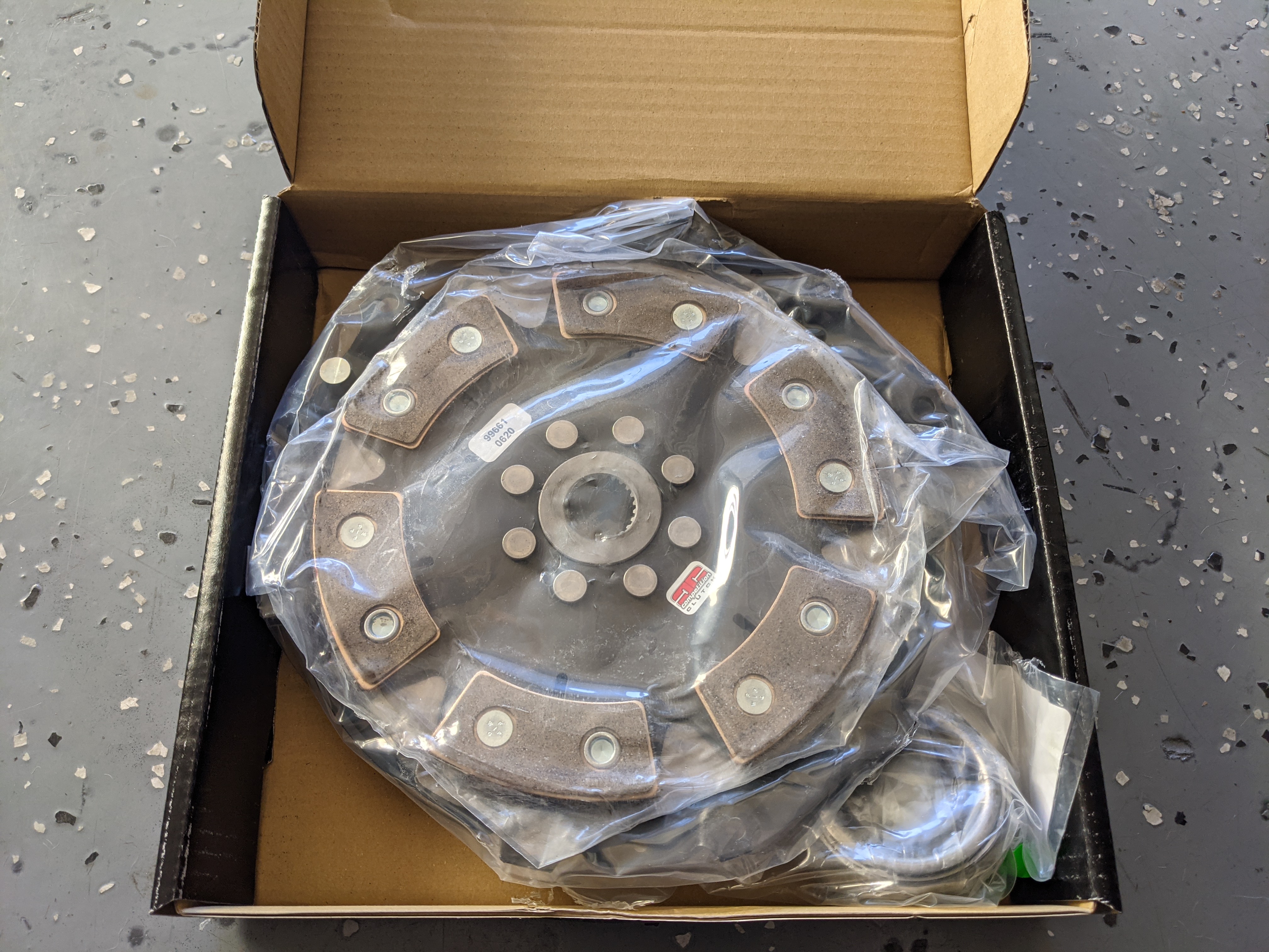

Also had the K20R flywheel resurfaced.
