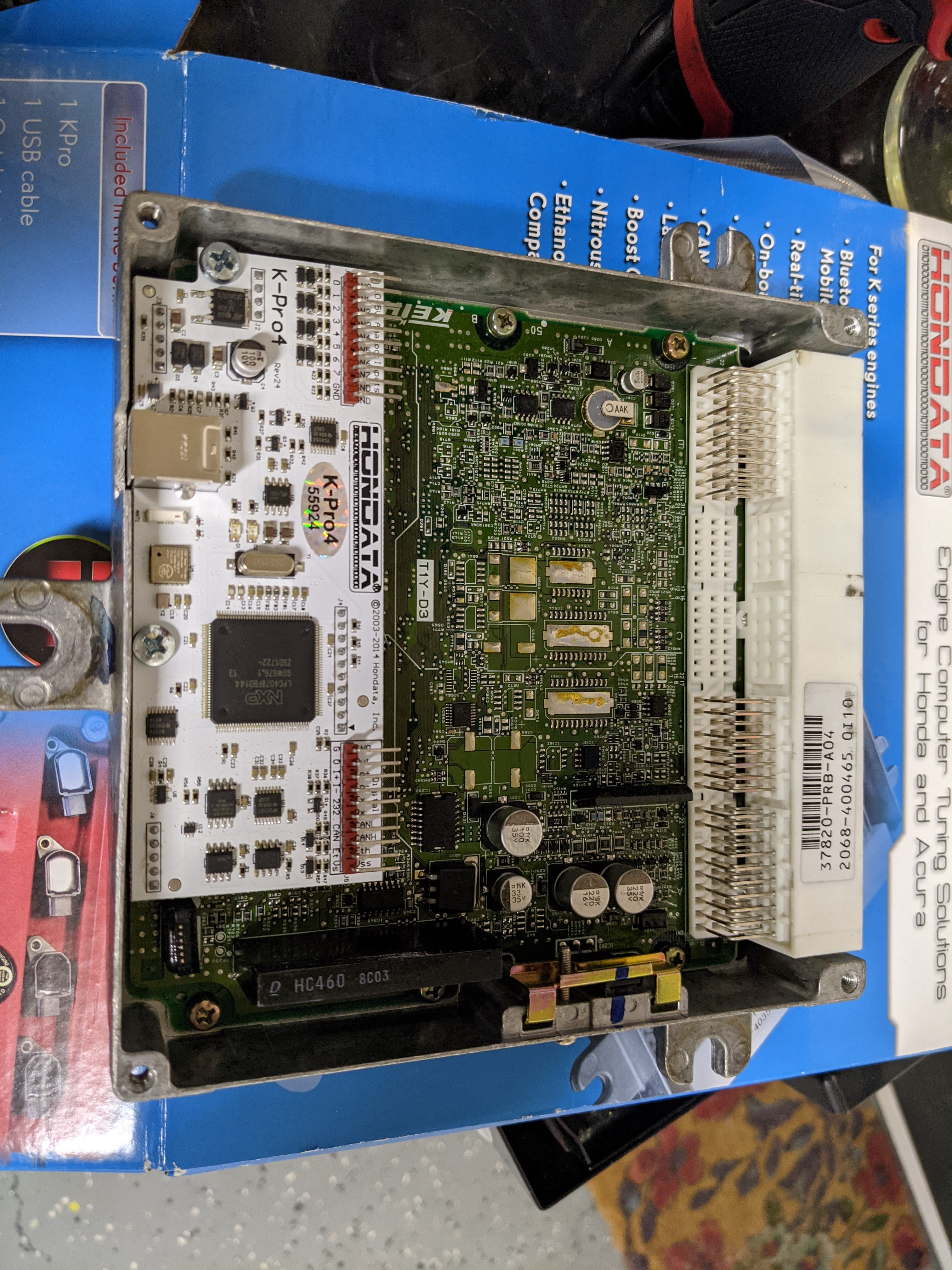

I did upgrade my KPRO to V4 though.

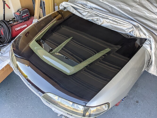

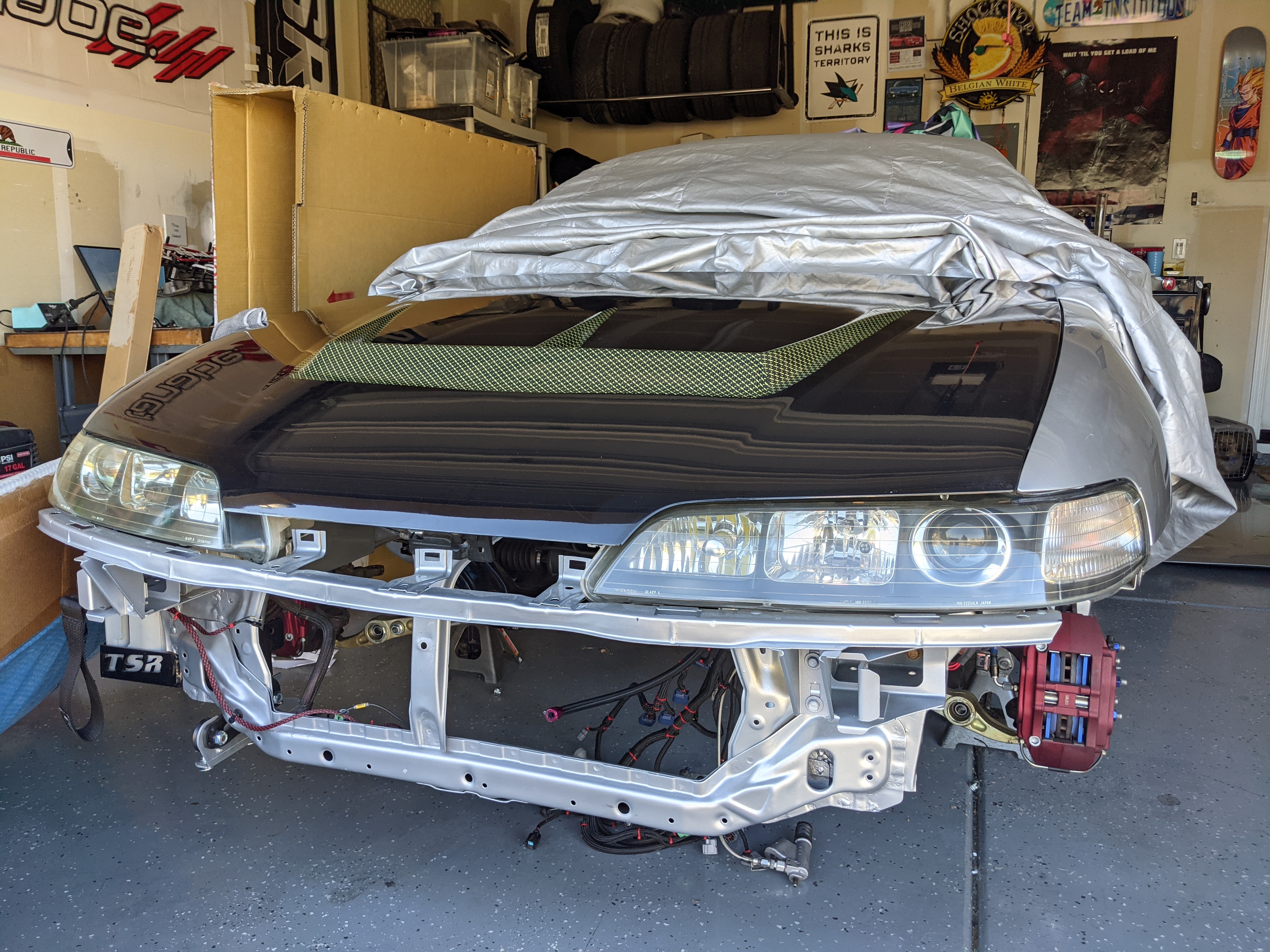

Picked up a First Molding hood a few days ago. I had my painter set aside some extra paint from when the car was painted, so I will be dropping off the hood to be paint matched. Being I have a bit of CF on the car, I’m gonna have it sprayed over the kevlar section as it would look off in my opinion.

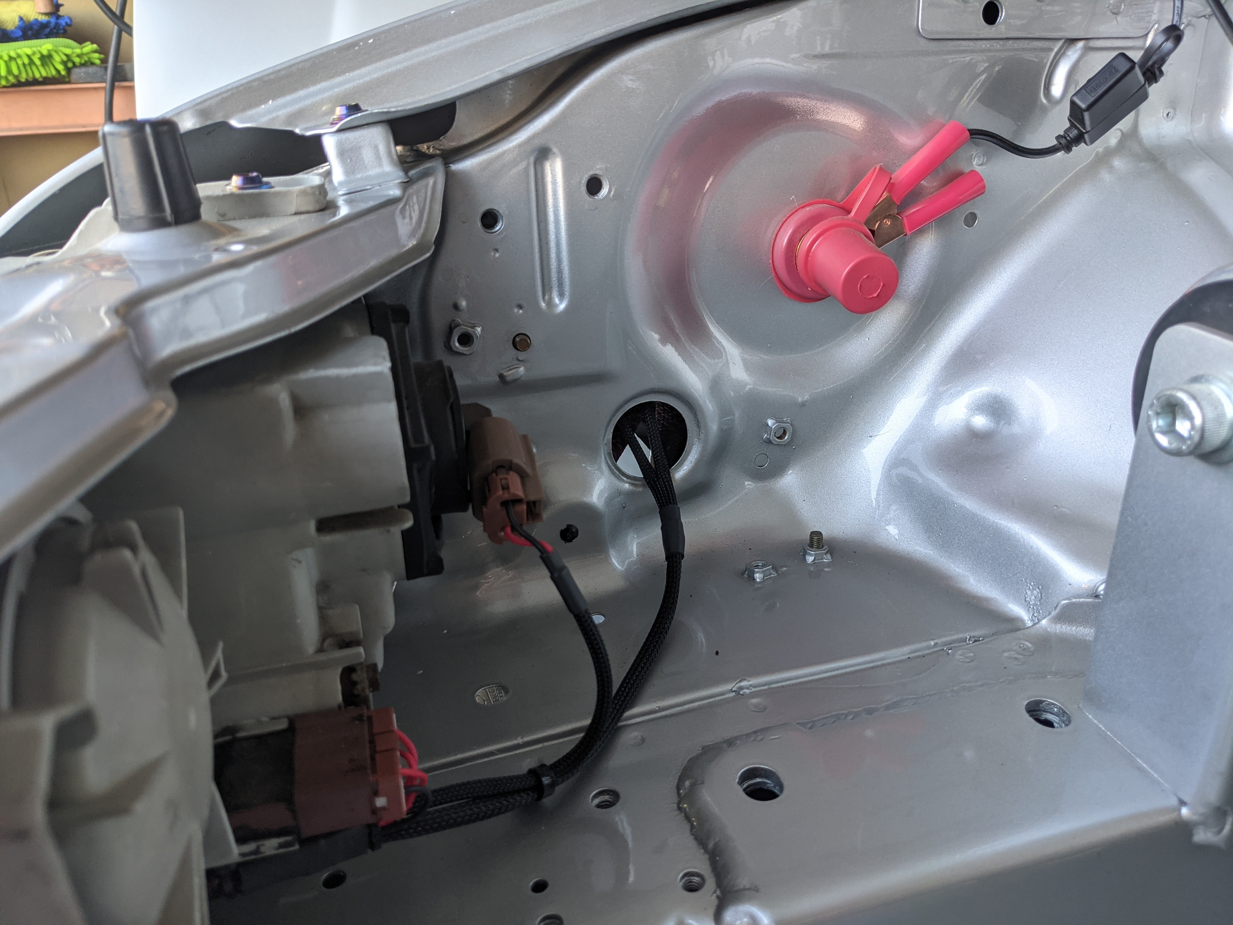

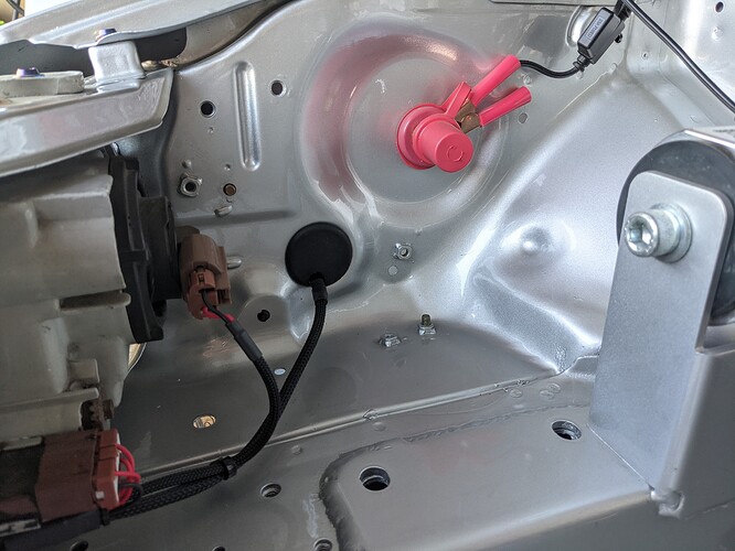

It bugged me that just about all the large holes in the engine bay had a plug except for the ones near the headlights, so I found a grommet that fit nice and snug. I punched a small hole for the headlight harnesses and installed.

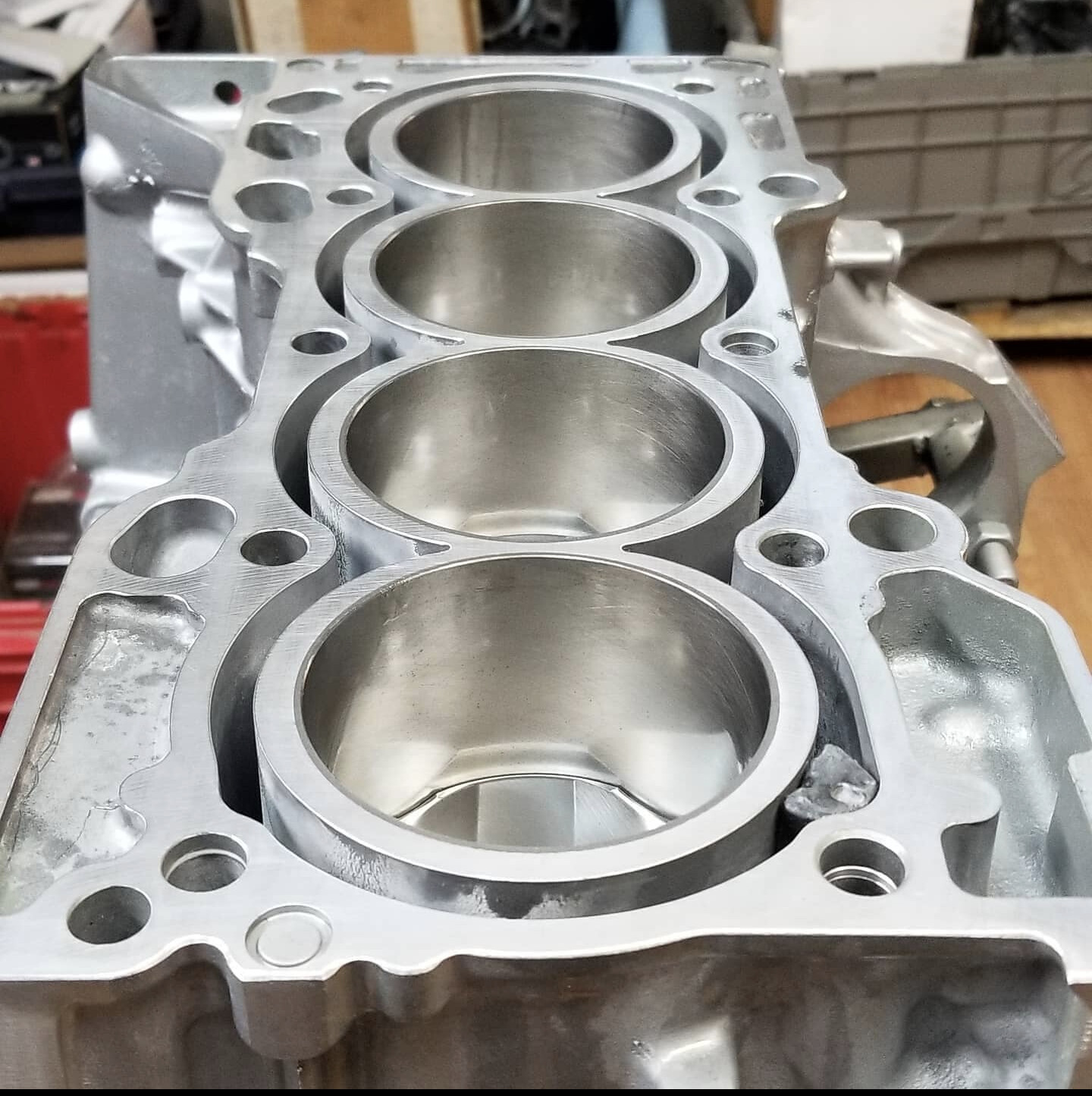

K24 block is “set” to ship next week, not holding my breath but praying it finally gets shipped. Will update when it’s in.

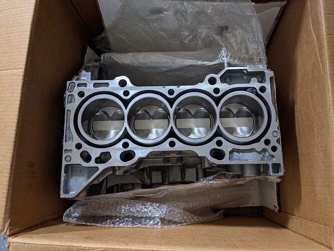

Block has finally arrived, 7 months later and it still wasn’t complete with what I ordered. I opened the package only to find that the modded PRB oil pump was missing. Note to anyone out there, KMOD Performance has terrible wait times (was supposed to be a 6 week turnaround) and customer service. Save the headache and go elsewhere.

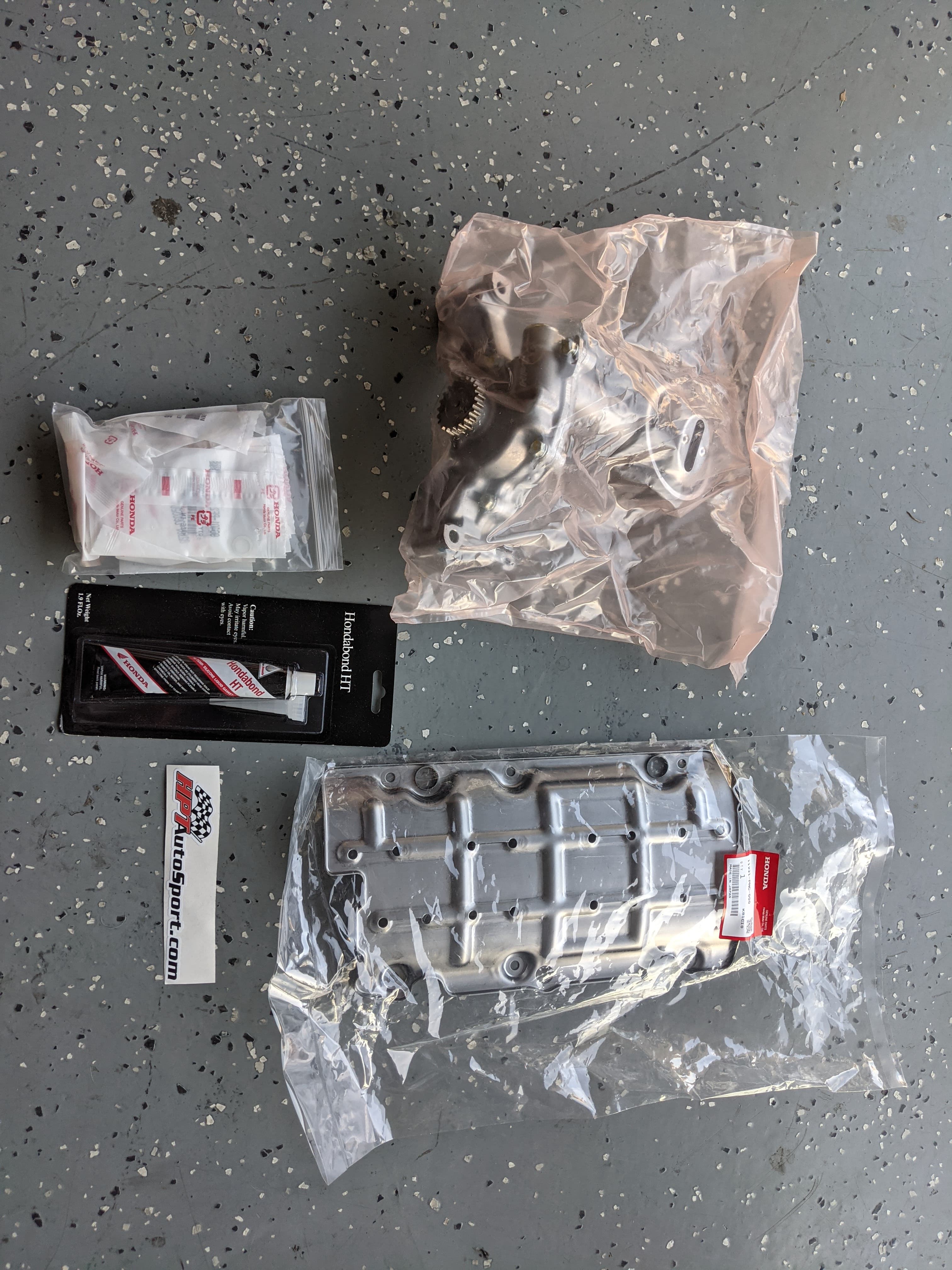

Ordered an oil pump kit from HPTautosport and should be here next week.
Thats some bull. I get they might be busy but a bit of communication is upfront isn’t hard. Glad they refunded it atleast.
Progress!
Oil pump kit came in

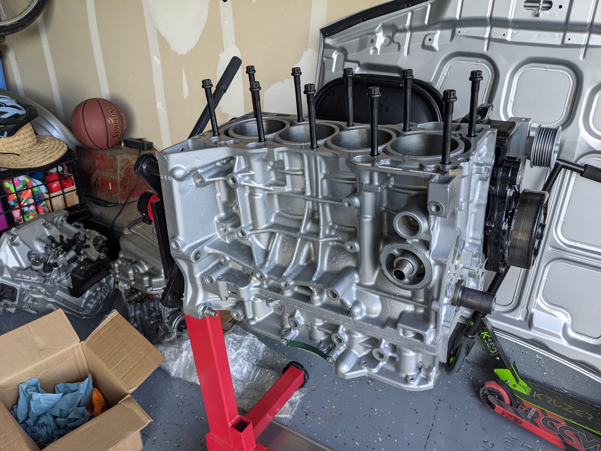

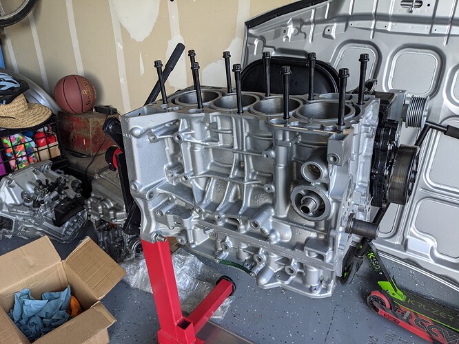

Also got the ARP studs installed and torqued down the head.

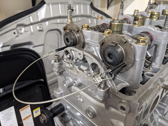

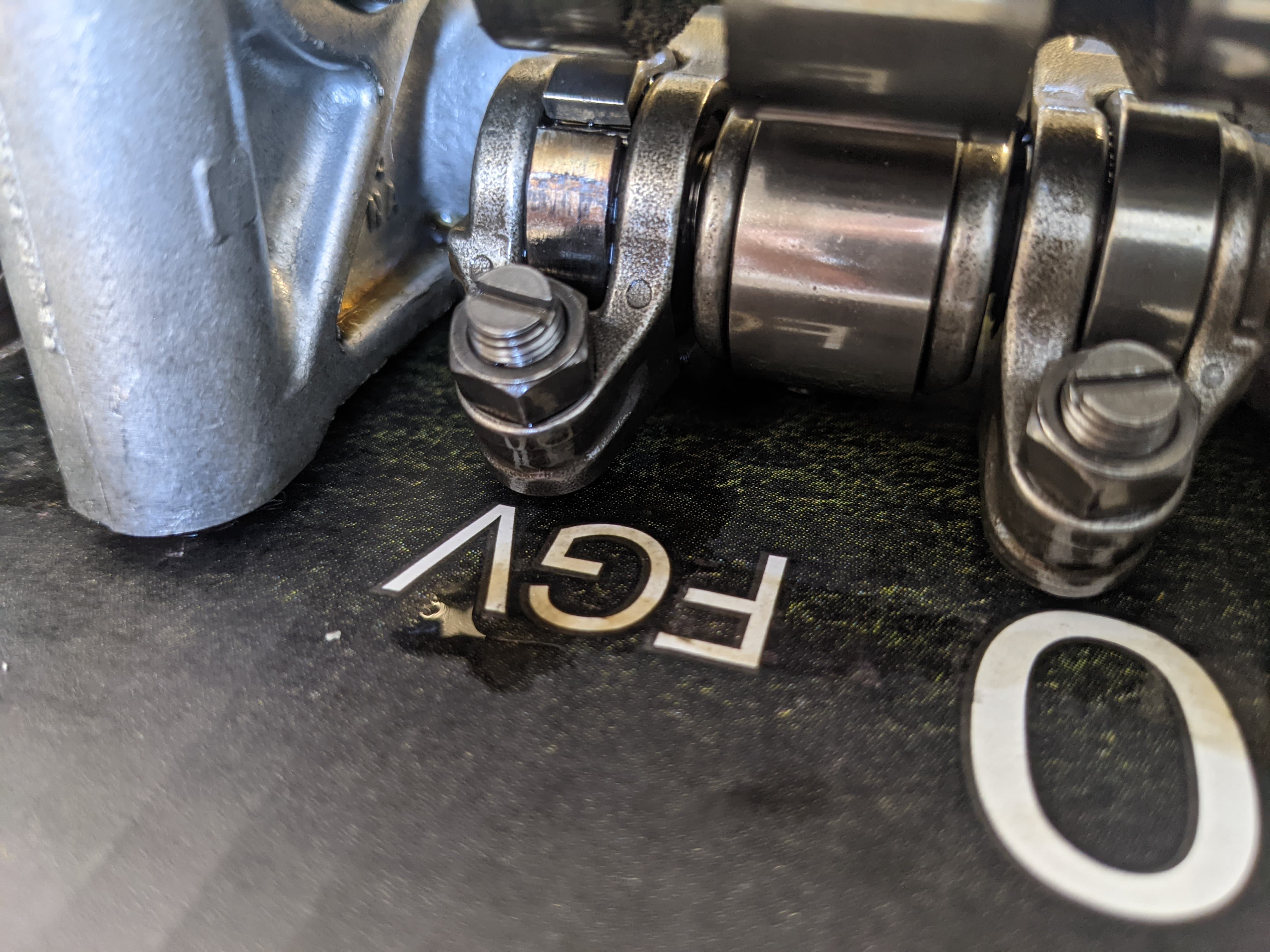

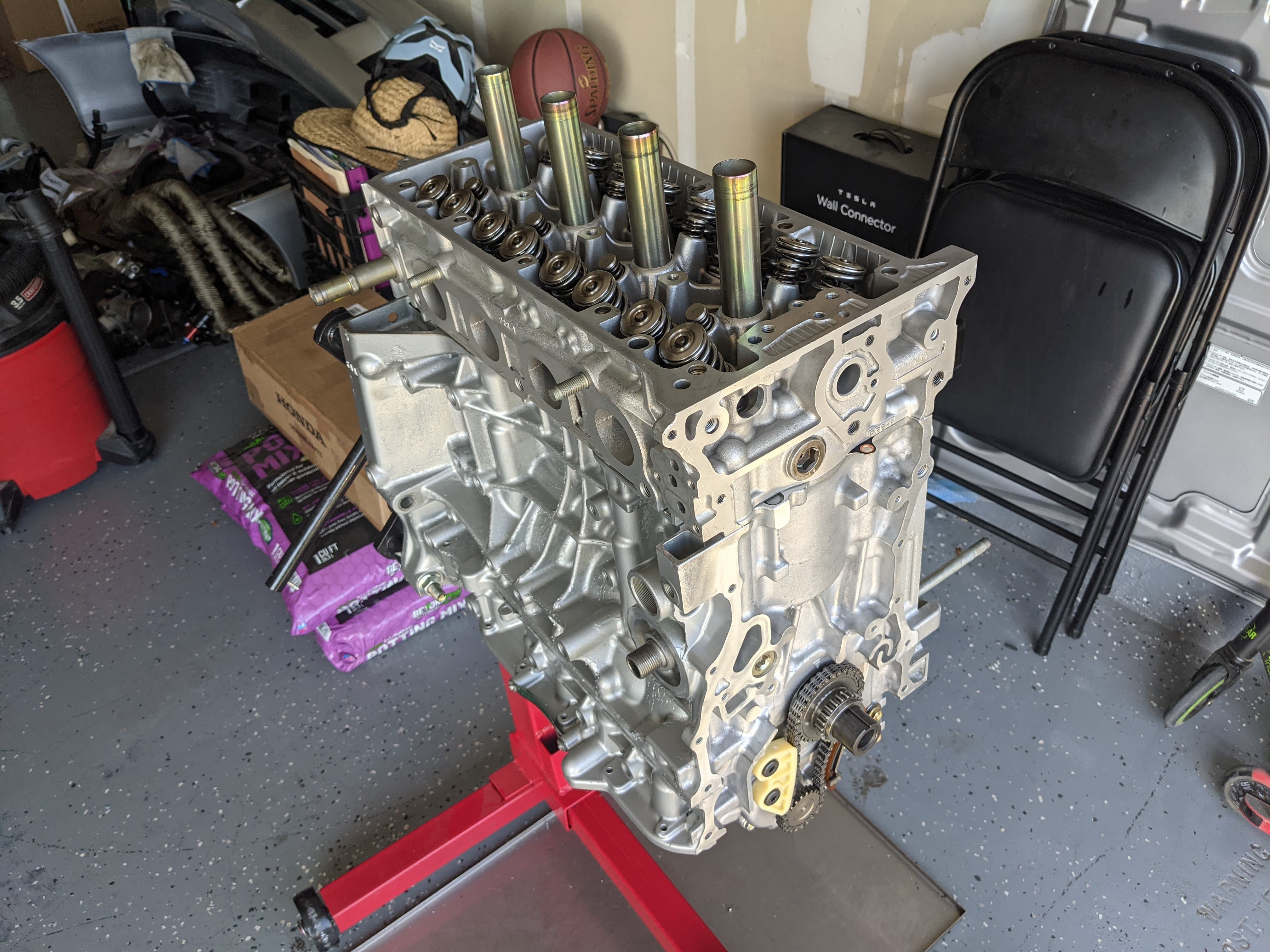

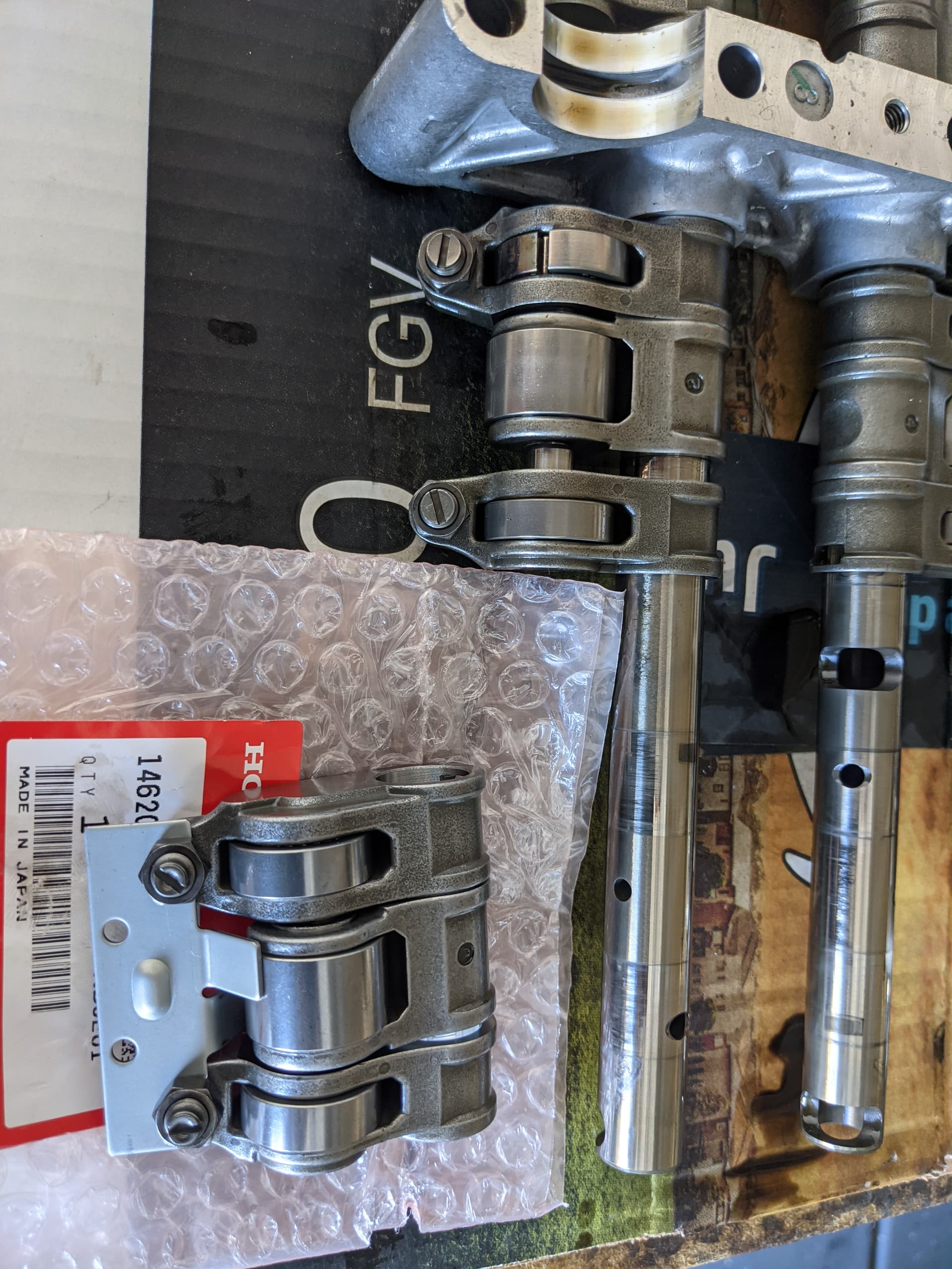

Came across a small set back as one of the rocker arm assemblies had the roller bearing go bad. Was able to order a set from the dealer so will have to wait for that to come in to get the timing done.
ß
More done on the K24/K20.
Replaced The bad rocker arm assembly
Lower chain guide installed

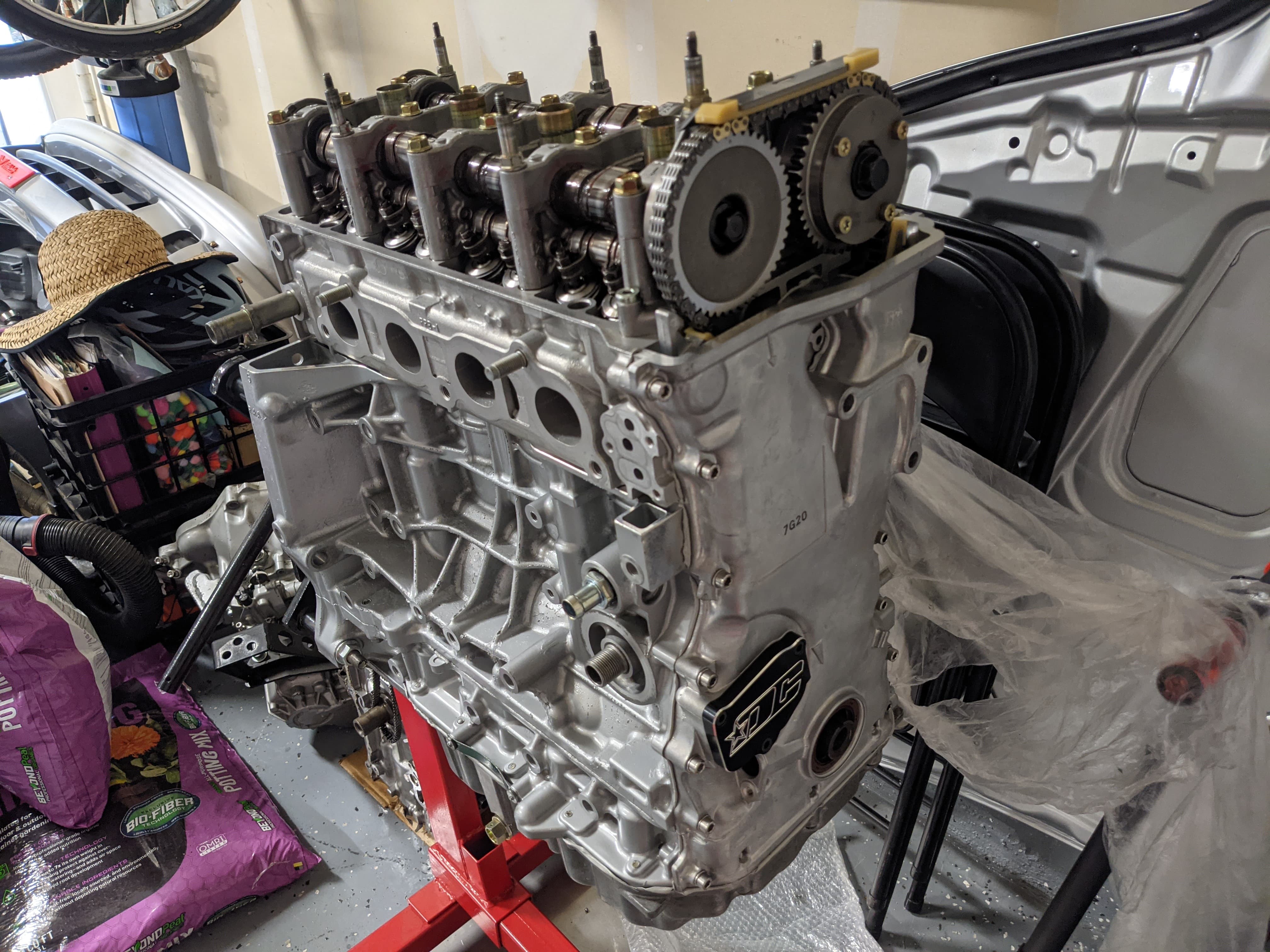

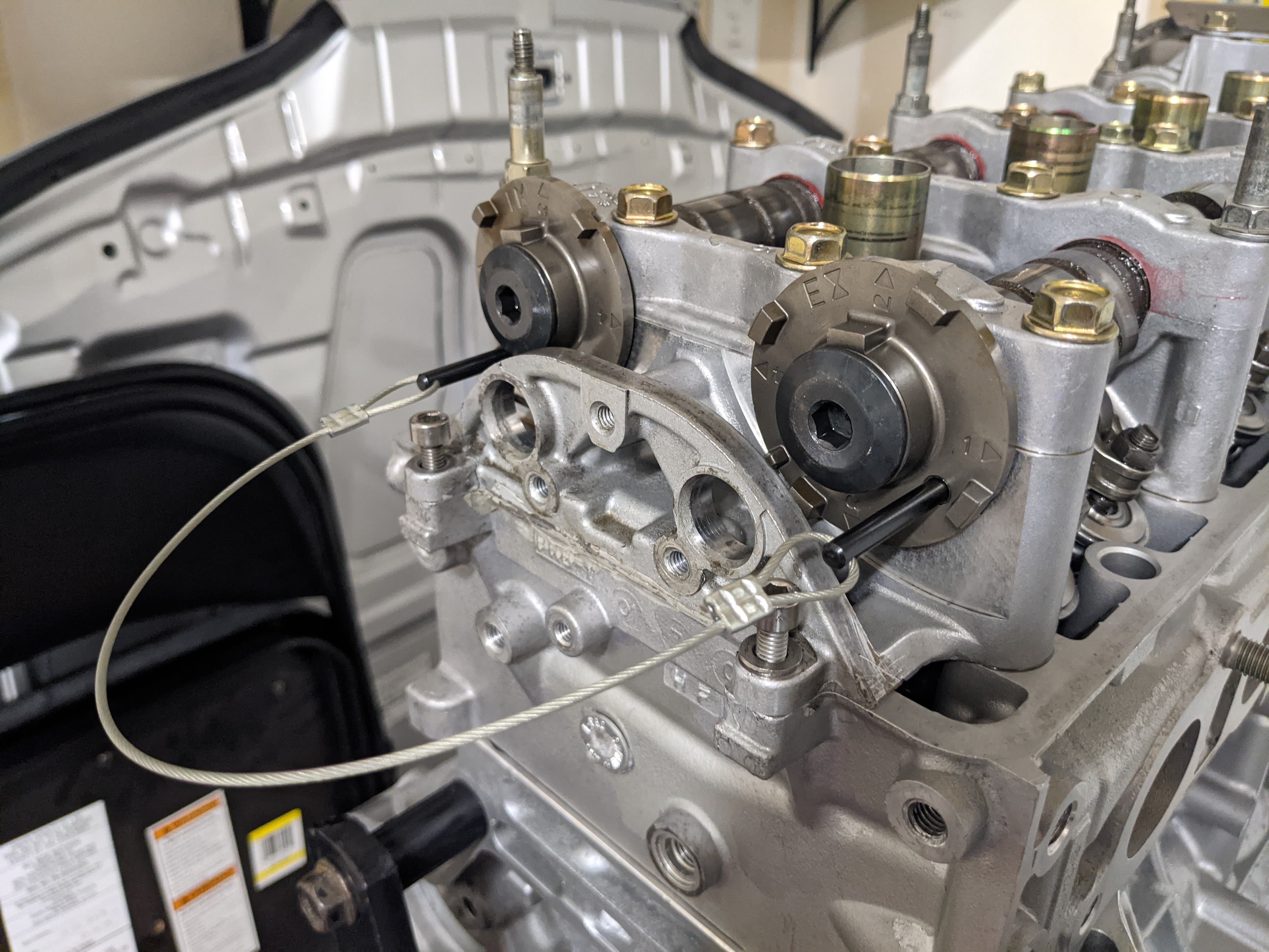

Timing done
Oil pan and timing cover on

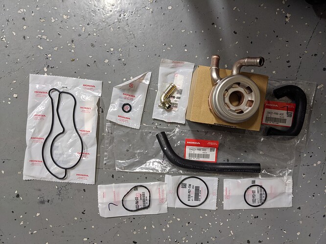

What are you going to use for an oil cooler?
That’s actually one of the backorder parts I’m waiting for. The OEM oil cooler. Was gonna use the one off the old K20A but since I spun a bearing on that motor, was told there’s a good chance bearing material could be stuck inside and it’s just safer to buy a new one.

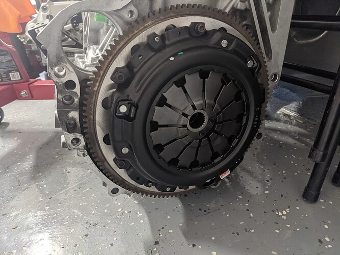

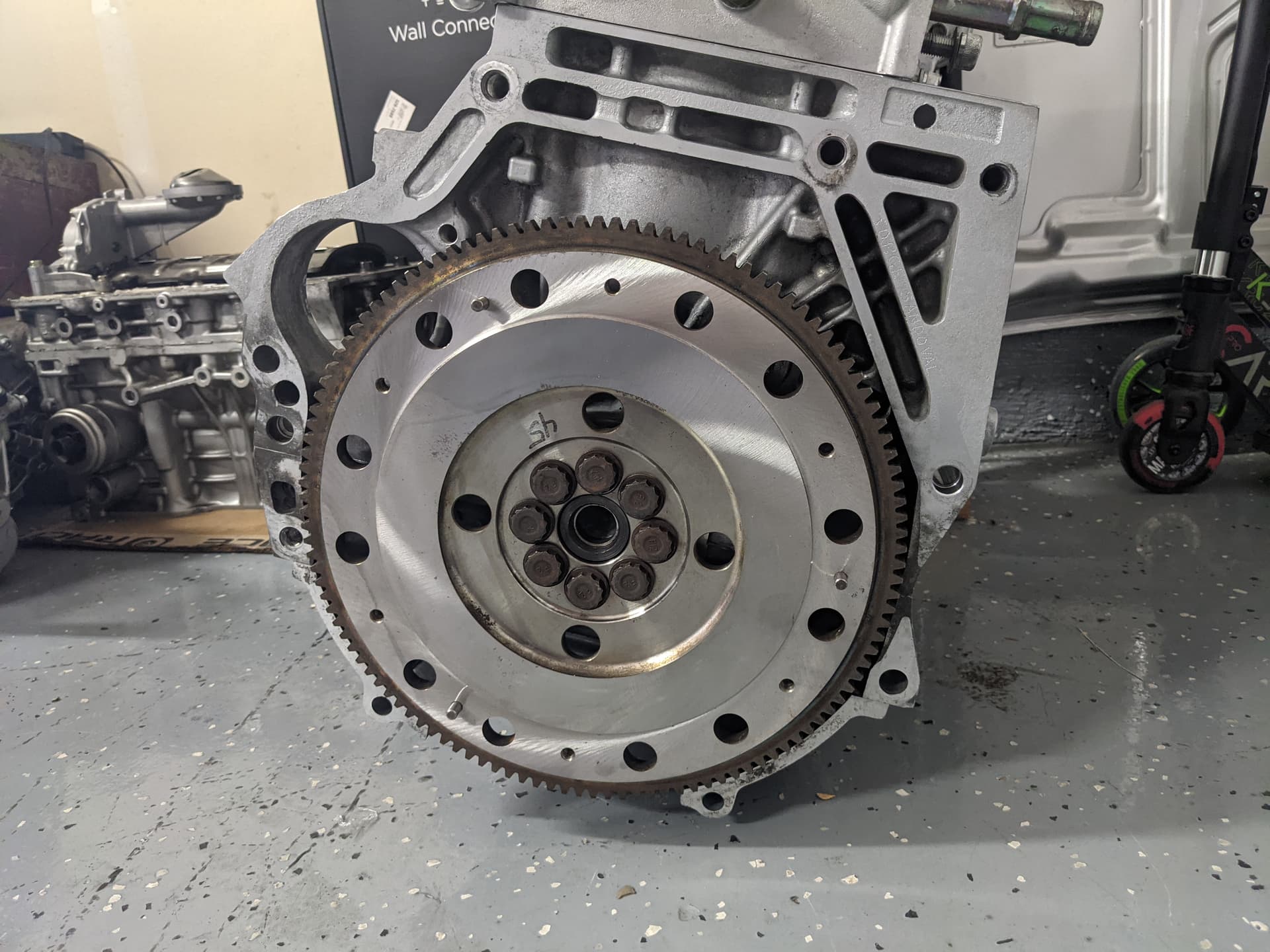

Flywheel and Clutch torqued on

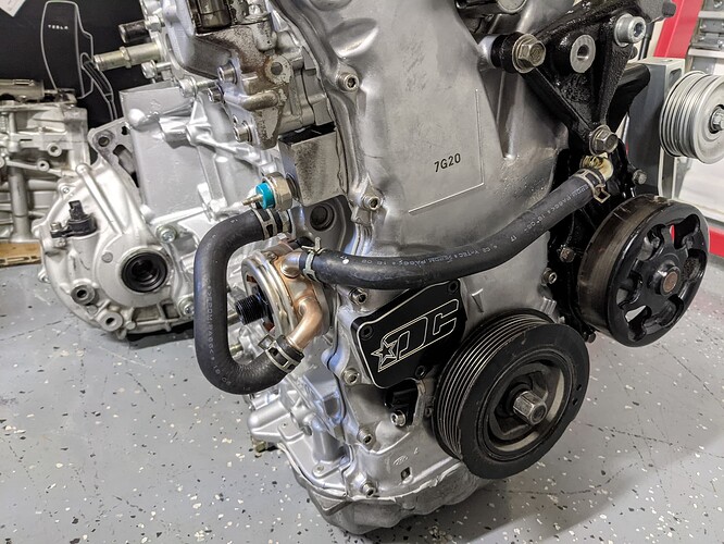

Back ordered parts arrived so those got installed.
Bolted up the engine! Should be up and running soon

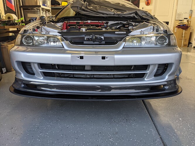

Had been lagging on installing the Racebred splitter. Still need to make some adjustments and possibly add an air dam but not too shabby!

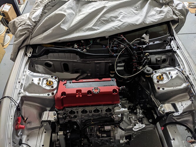

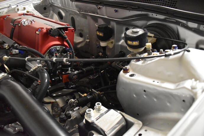

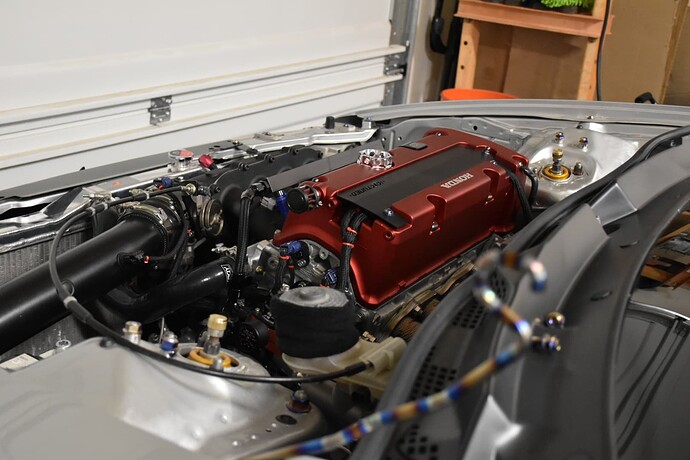

Also some engine bay shots now that all the components are in place.
Looks so good! I bet you are excited
Definitely man. The last time I got it running with the K20A, it only lasted about 2 months before it went back in for surgery lol.
