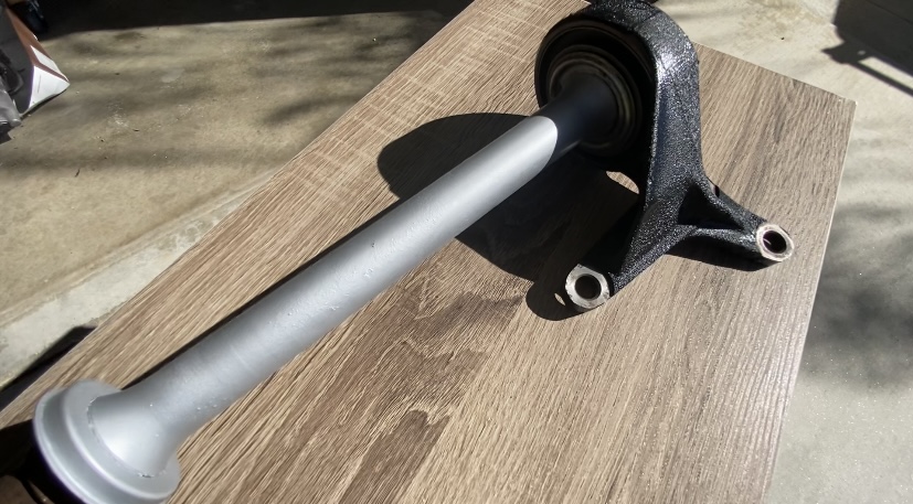

Got the half shalt cleaned up and had some rattle can fun

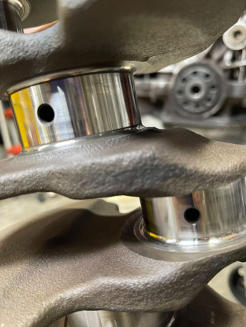

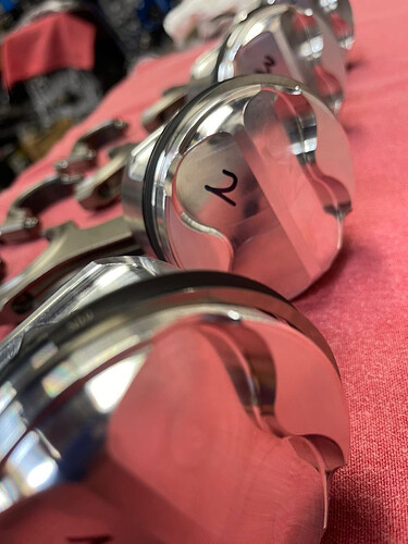

Motor is back from the machine shop and the domes on these pistons are like :exploding_head::exploding_head:
So i wanted to run 11:1 pistons and well I ended going with 12:1 arias pistons instead. Bore is 81.5mm with eagle rods and a polished GSR crank, hence making the B16B now a 1.8L :sunglasses:
I just need to order water pump, oil pump and timing tensioner. Then next is rebuilding the head.

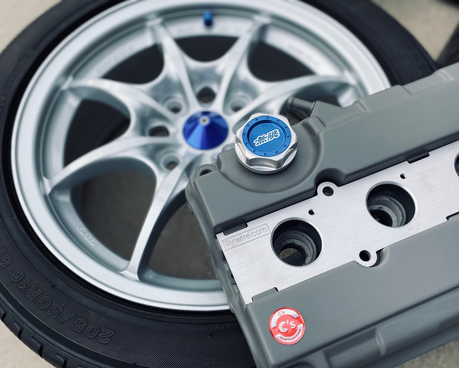

Sometimes i forget i have these wheels :face_with_hand_over_mouth: but i wanted to share a few parts and a teaser of the color I’m going with even tho i decided on the color a few years ago. Fun fact the color is an oem factory color from Honda :sunglasses:
