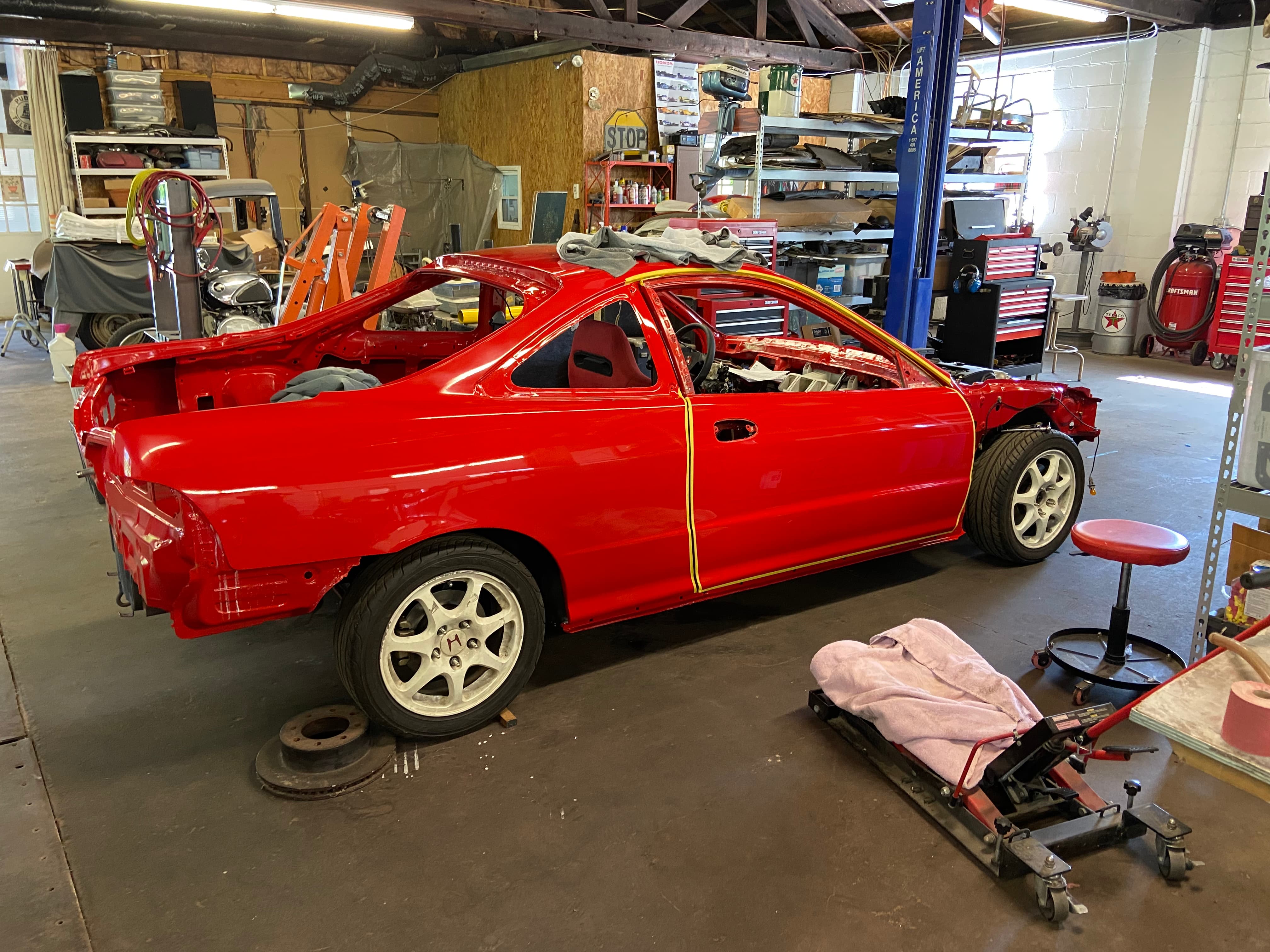

Once we got those pieces painted, I got back to work on making the car run and drive so I could get my dyno tune scheduled. I wanted to get all the underdash assembly finished before I put the doors back on just to make it easier to work in the car.
I did run into an issue where I left the fuel tank harness on my tank that I threw away and dint have a connector to hook up to the fuel pump. I was able to find a used sun harness on eBay with just the fuel pump and sending unit connections and found a electrical supply shop with the other half of the connector from my chassis harness.
Next up was getting the axles in, fresh fluids in everything and finishing up conversion wiring (making everything plug and play) and power wiring. I ordered a wireworx charge harness kit but the lengths didn’t work (even after I specified everything) so I went and made my own. Wish I would have just done that to start.
After all this, we hung all the freshly painted panels on the car, then wet sanded and polished them.
Once it hit that the car was extremely close to running, I booked my dyno tune and ordered some tires for the wheels I’d been storing for years.
