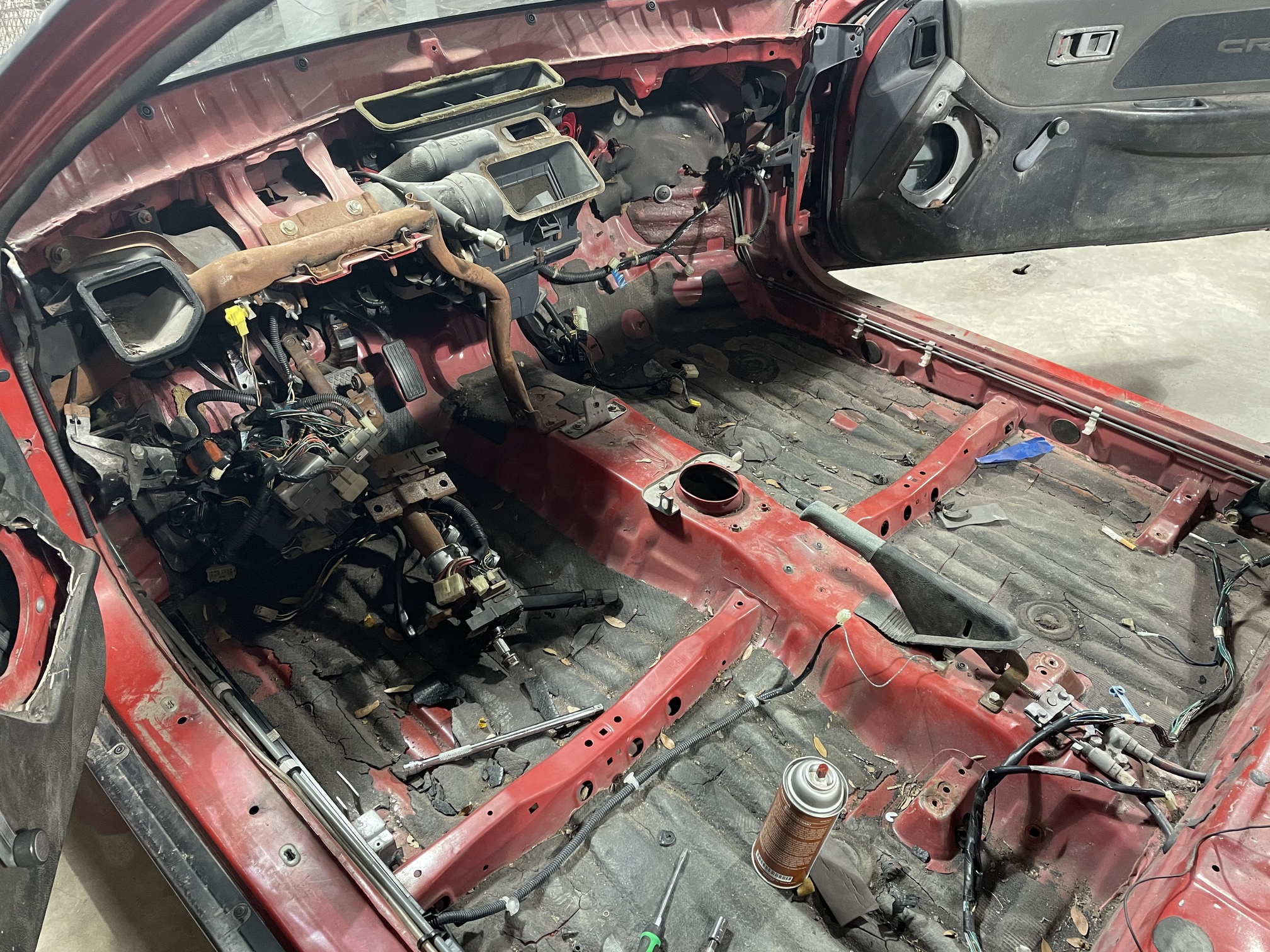

While i had the dash out, i decided to paint it black. I ran the interior wires a little better to tidy it up. I found an oem ac bypass because fuck finding ac components
Also found some camper insulation that worked somewhat ok for the “gasket” for the air ducts. Bolted the dash back together. It wasnt much done but progress is better than no progress
That’s right, better some progress then nothing at all. Hope I can get some stuff done this saterday too.
I used some adhesive backed foam for the ducting in the dash. Found it at local home improvement store, normally this is for doors and windows but works great.

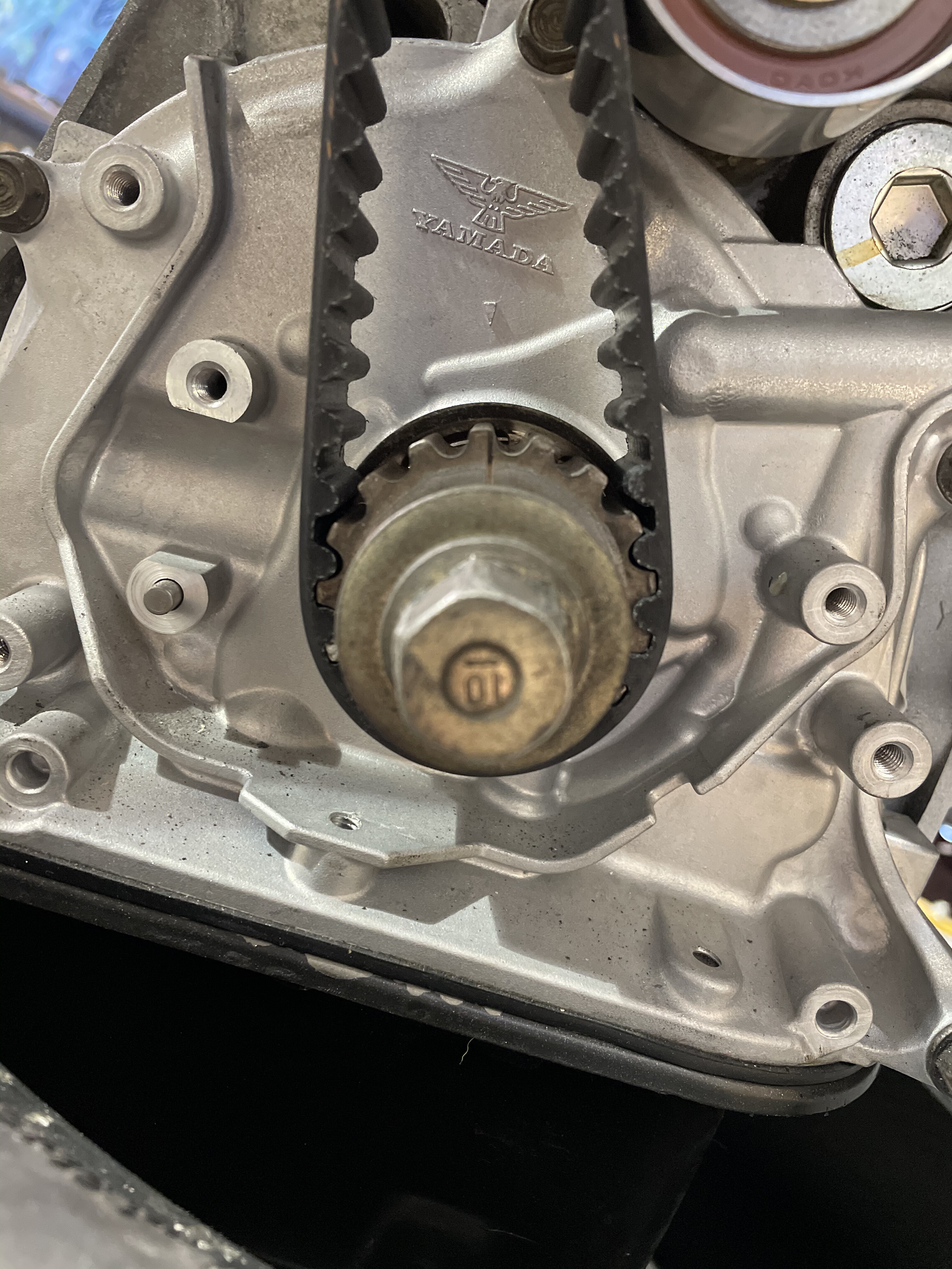

Had a little snag with a timing belt issue. But did the timing and got the tranny on. Also did a little miscellaneous cleaning of the shop so i can throw my tools a little further

Sunday was very uneventful, sprayed the vc gasket, couldnt bolt it because i dont have the tube seals… bummer. Took apart the sunroof because the panel is rusted out. Planning on replacing it with a cf panel. Also lubed the channels and fixed some miscellaneous electrical issues. Also big shoutout to eryk.crx on instagram for hooking me up with this sweet climate control swap from the accords.
