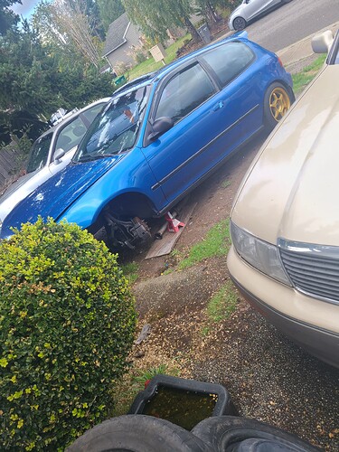

This was her after i bought my first set of wheels
Her right now

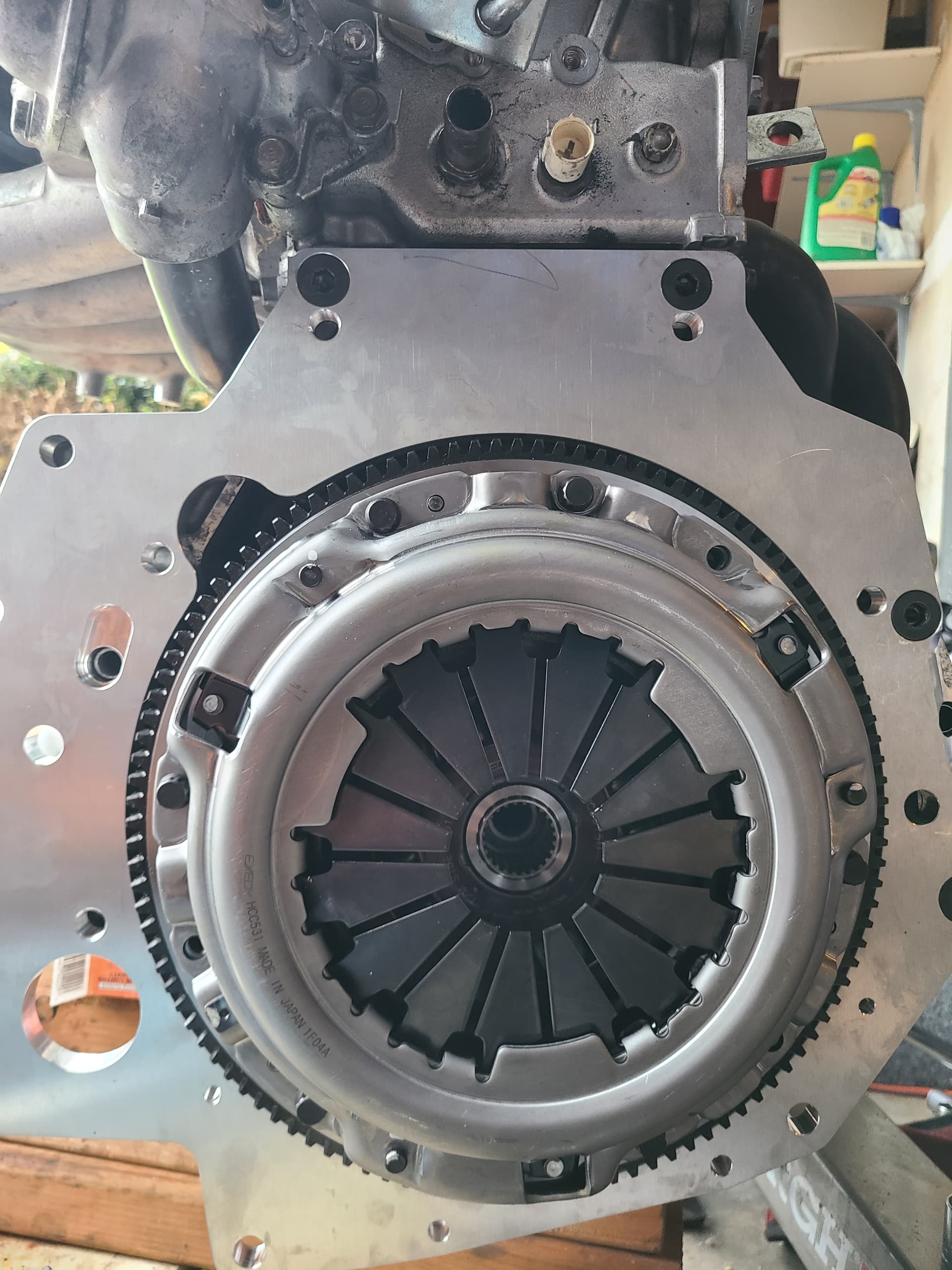

So far I’ve grinded down the dowell pin, put on the h2b adapter plate, and the crank shaft spacer.

Flywheel comes in today so I’m just waiting on that to get here…

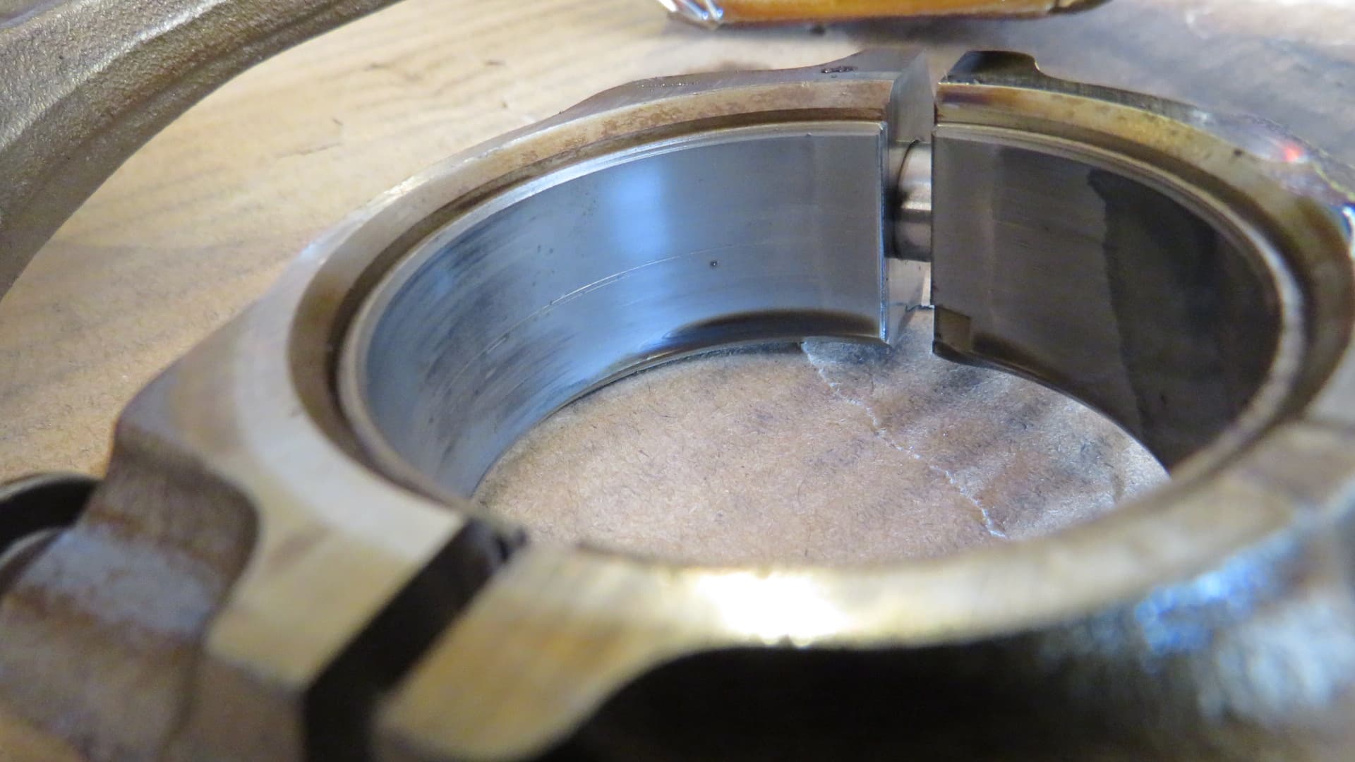

and one on this one bearing
but at least they aren’t too serious…
