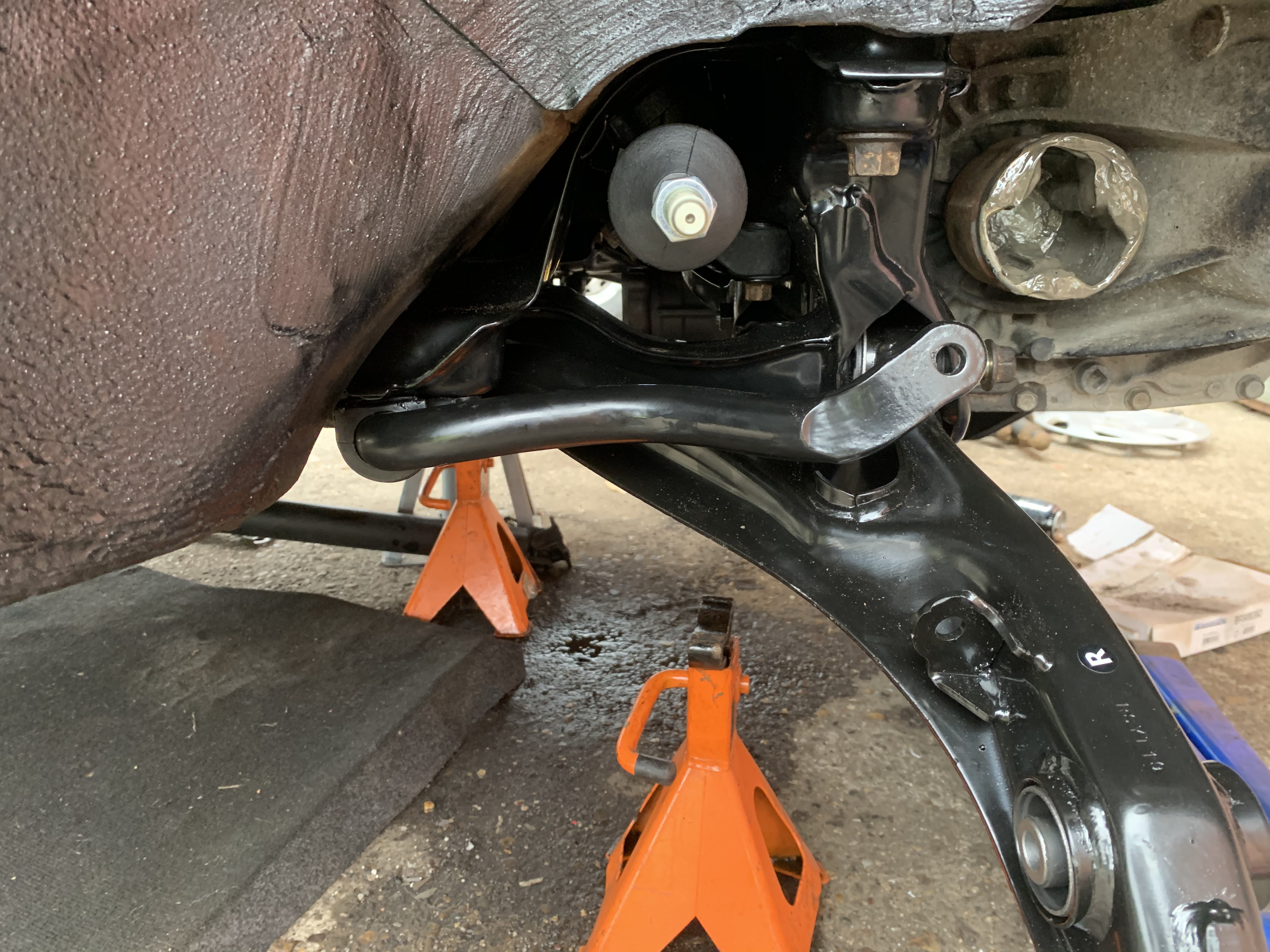

So I started with the chassis, although the bottom of the car already was stupid clean, and cleaned it up and applied a new coating
Then I pulled the front subframe, steering rack and suspension.
I had an EK9 subframe and swaybar to spare so I had these sandblasted and powdercoated to install on the orthia, together with new hardrace upper and lowers, tie rods and endlinks
A new set of driveshafts are waiting aswell, Hence I didn’t really care about pulling the old one out in one piece.
Spindles and brakes are up next…
