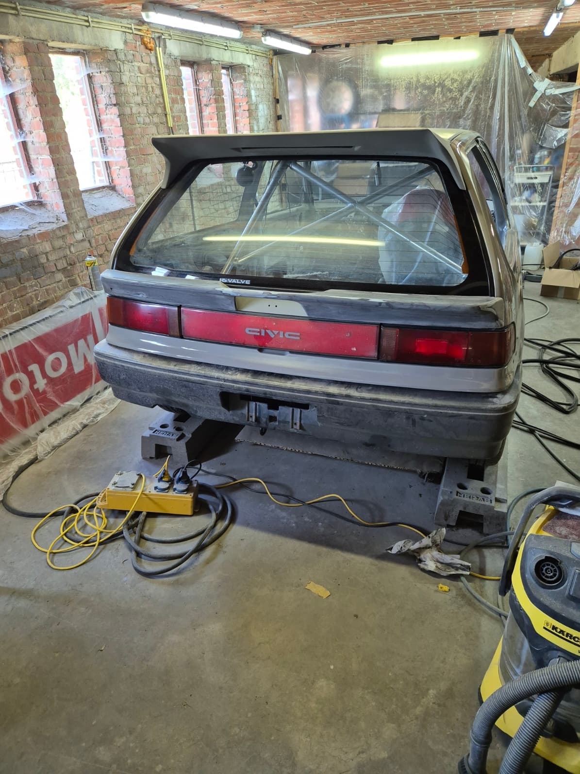

Finished up the rear interior harness.

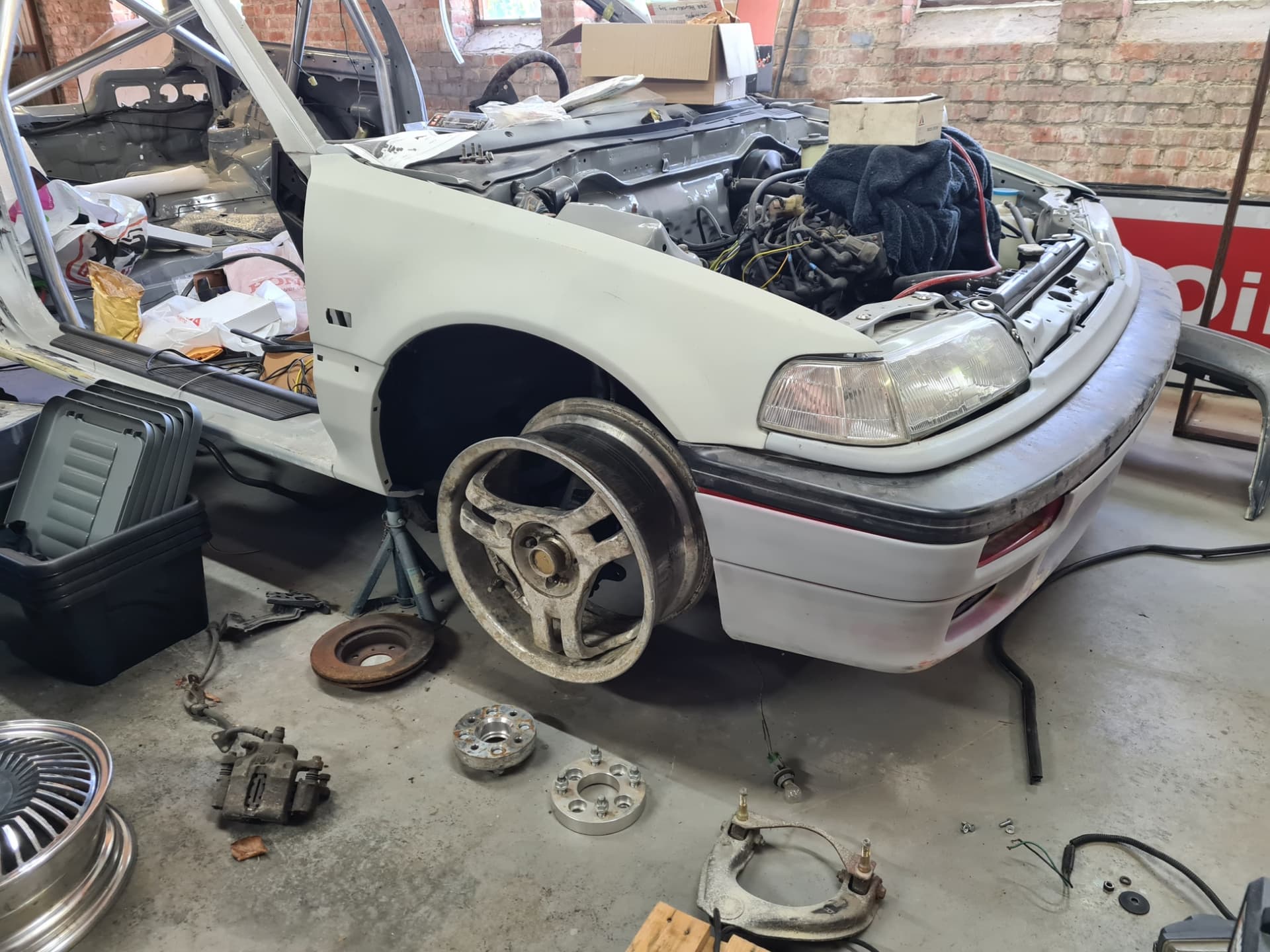

Did some more sanding on the drivers side and yesterday my newest addition to the wheel collection arrived from Japan :smiley: Carving Head 40’s
Taking them with me to the warehouse tomorrow to see how they look on the civic.

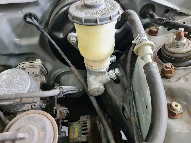

Got the prop valve and my brake lines out, just need to cut the rear ones inside but need to check where to best do it so I can route the lines inside that they don’t stand out to much since the inside will not have carpet again.
Still have brake line left from my EG build, so can start mocking up where I want the lines to go but need to take the dash out again first to check on the inside if it all clears.

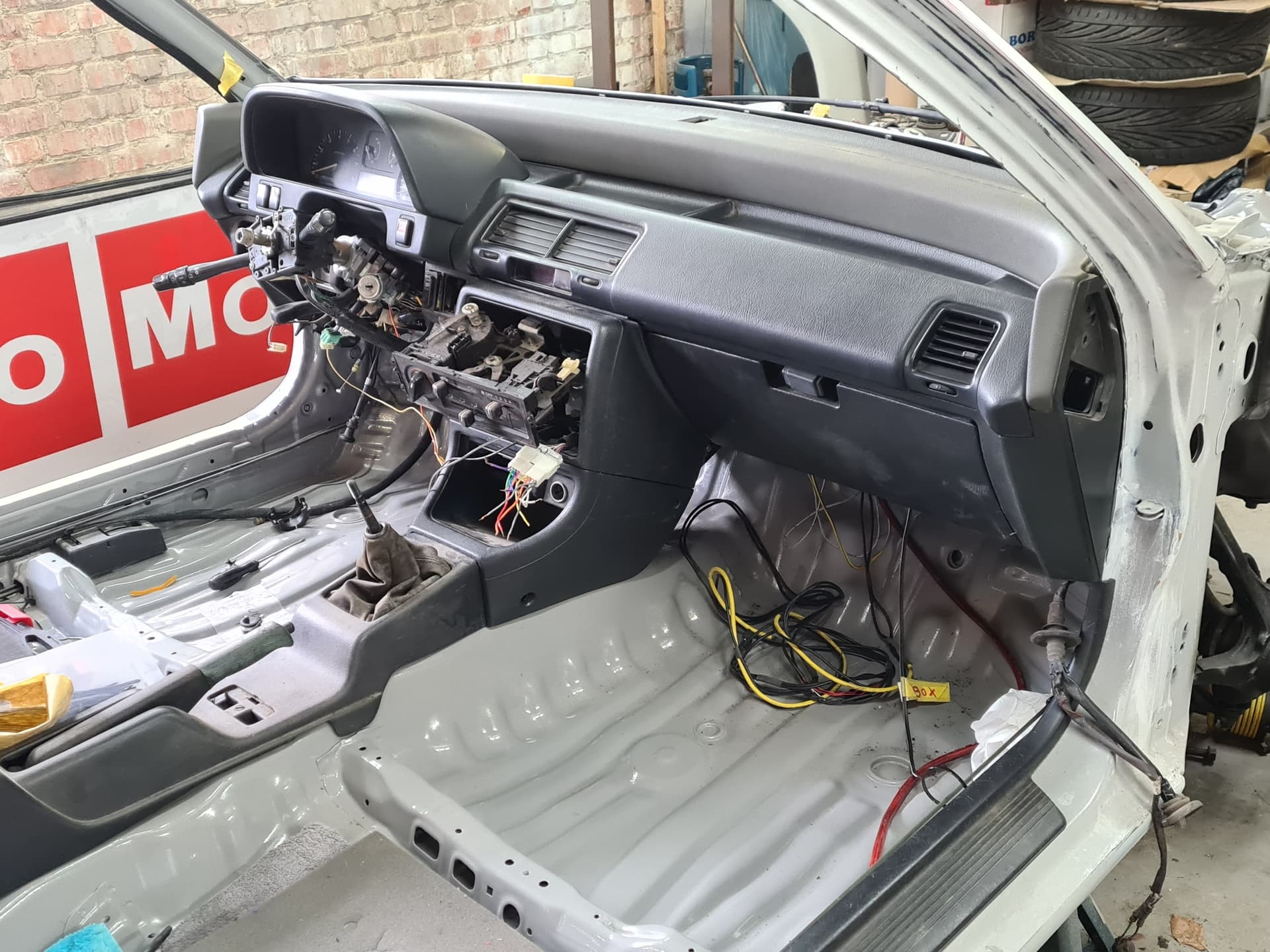

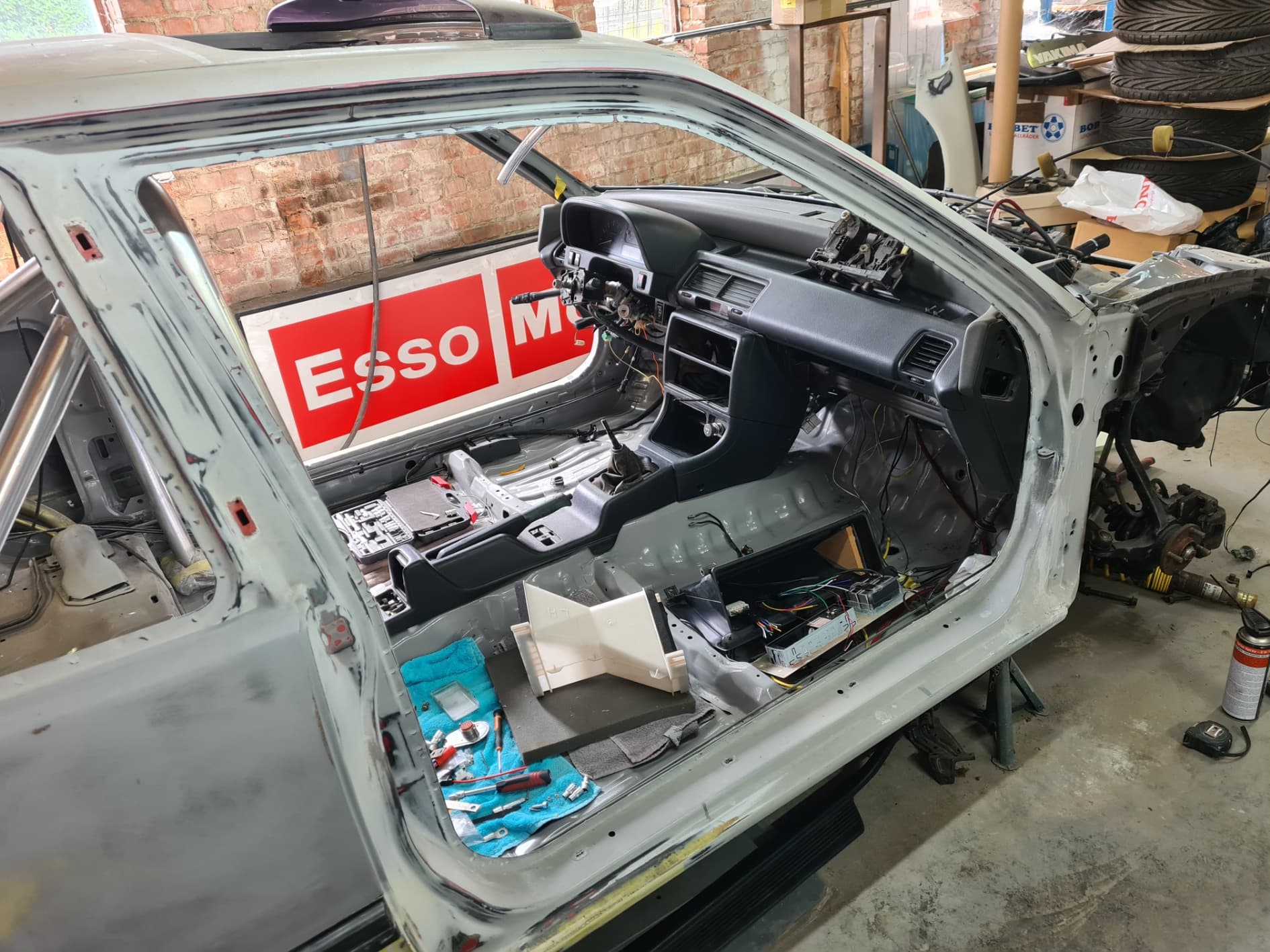

Got the dash pretty much all together to check for clearance underneath and see if nothing is interfiering with other pieces.
Wired up the front foglights, extended the wires for the radio because mine will be in the glovebox and cleaned up the front bumper mount and suspension triangles. Starting to look like a car again. Hope to get to the engine harness soon but they send me crimping pliers for the wrong size pins …

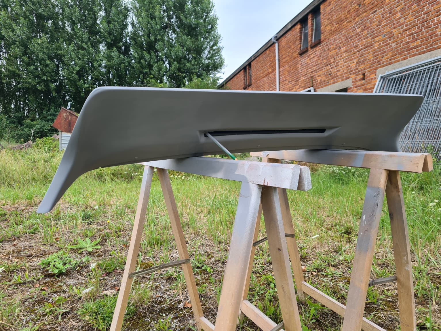

Got the Chargespeed spoiler sanded down. Looks whole lot better then before, few touch ups to do but it’s getting there. Warehouse looks like a mess again, need to get that sorted soon.

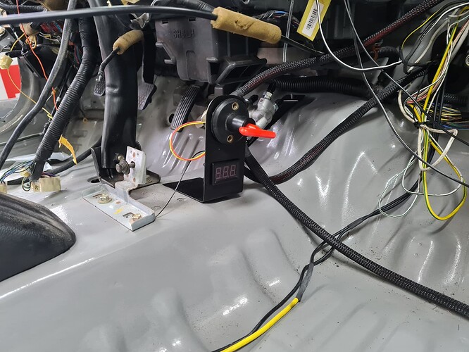

As you can see, the size is a bit different so had to make a new battery stay, and a new mount for the kill switch and digital volt meter because I changed my mind on how I want to finish off the interior quarter panels.

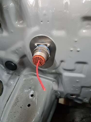

Got the car end of the mill spec connector wired up and put in place.

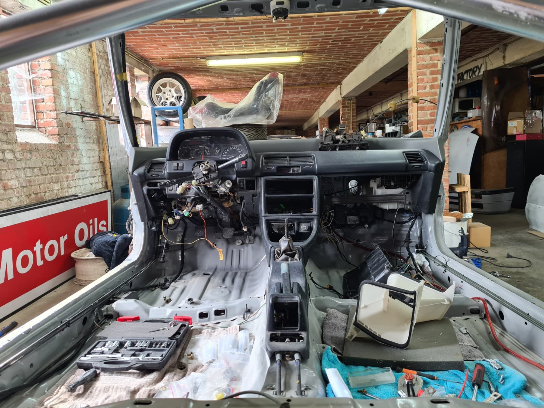

Also need to take the dash out again so I can tidy up all the wires and take measurements for the flex brake lines for the inside so I can get those ordered also.

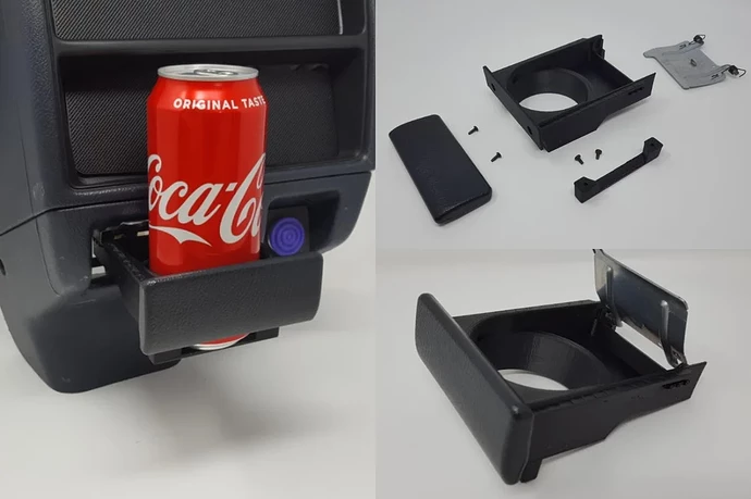

Almost forgot I got my order from Gregparts in last week too, cupholder for the ashtray and a block off that was missing in my dash.

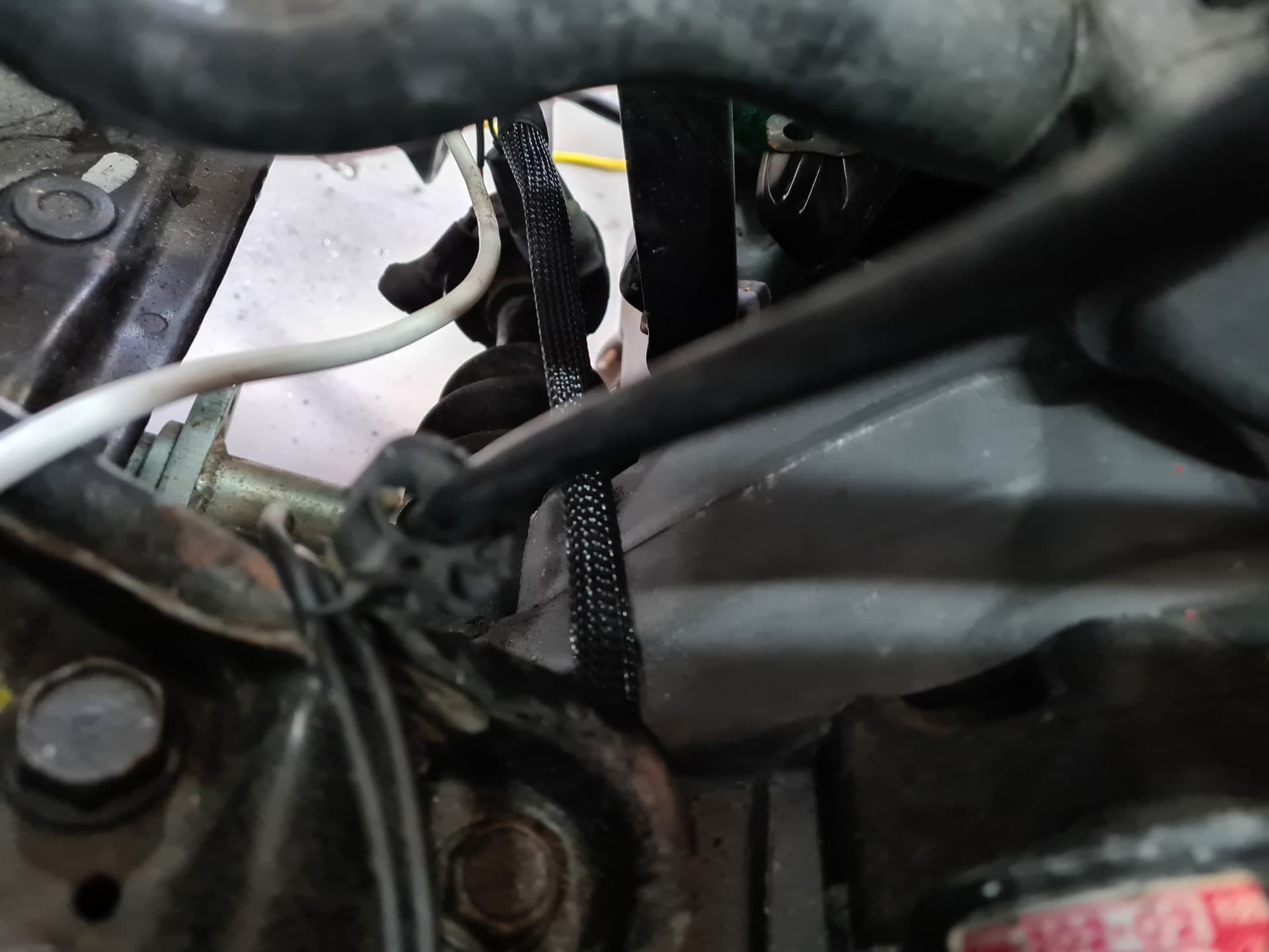

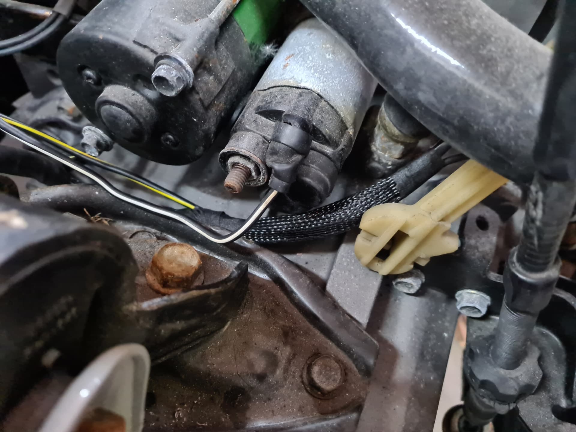

Have been busy the past few weeks with the engine side of the harness, needed to search for a couple of sensors on the block because I had a few connectors without a destination. Big thank you to the UK guys on facebook for the help.
Needed to replace one of the power cables because there was some conflict in where I put it and needed to make a longer one so it could be put in a better position. But all wired up now and we have power.

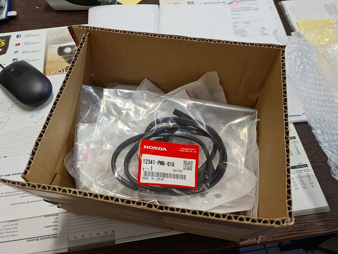

Got a bunch of red label parts in this past week. Should be almost everything I needed to get the engine sealed up.

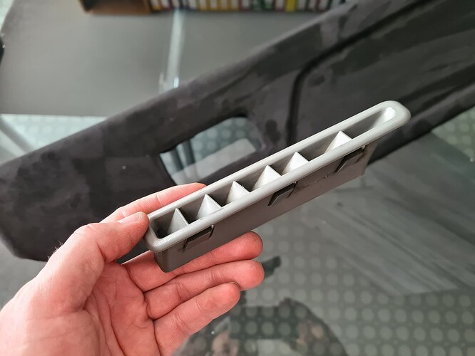

Refinishing various trim pieces
Took my doorpanel apart to give it a much cleaner look. Still have to do the drivers side, was my last piece of alcantara at that time. Need to paint the vent piece black.

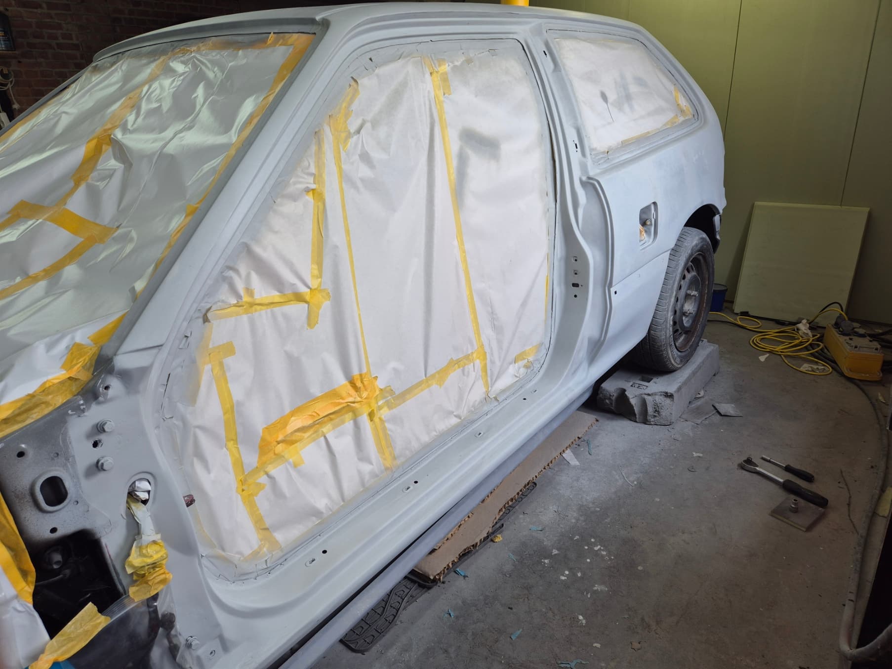

Sanding and prepping the body for paint.
